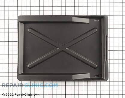

Hello all, Thanks for the help earlier with my Sub Zero question in the thread below.
Having a new issue. I think very simple. Today heard water dripping in the fridge area. looked underneath and noticed a puddle and water dripping out of a hose.
I think I am missing the black plastic tray on the bottom that catches this water normally.
Looking to understand the theory behind this tray and water. I am guessing it has to do with defrost. The fridge goes into defrost mode every once in a while and water drips into that tray.
Then the water evaporates naturally before the next cycle??
Is this right??
Thanks
Dave

Yeah, there ought to be a pan there....where did it go? Things that make ya go hmmm..
Is this right??
Thanks
Dave
http://appliantology...__1#entry213741
Sufficient water will evaporate before the tray can overflow. Either your tray came out when you moved it, your tube got out of position, or a leak in the tube/tray

The tray is missing. have a cookie sheet under there now.
Guessing I should get the right tray, but I looked in the service manual someone on this site sent me and there is no part listing for the drain pan. I see the drain pan heater,( which I guess helps the evaporation of the drain water process) but no pan?
Anyone know the number or where to buy it cheap.
Drip-Bowl-or-Drip-Pan-2120121--00991789.
Repairclinic has the picture but doesn't sell the part anymore...sears has the part but not the picture...
