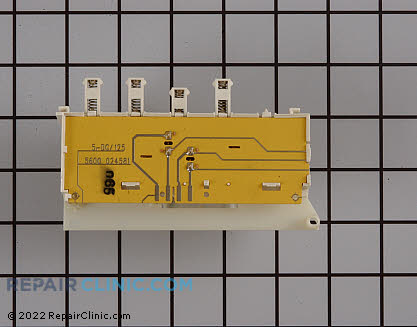

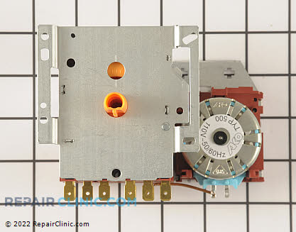

Now I've got two of these doing this. Both are intermittent problems, so it's hard to test. On both the timers hang up in the wash cycle and won't let it finish. Likely heater circuit. There's no control board, it has a timer:
So I'm sure that it isn't the usual unsoldered heater relay.
So if I can't get it to do it while I am there, what can I do? Replace something and hope for the best?
Now it could be the selector switch
but there is nothing visually wrong with that.

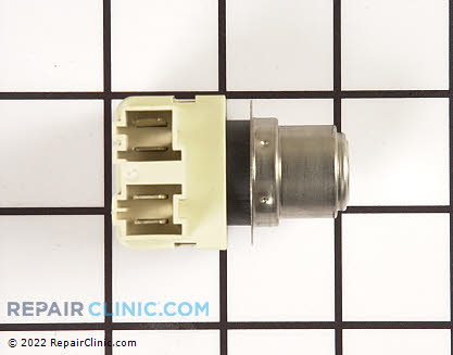

On one of them I tested the regulator
but that seemed okay.

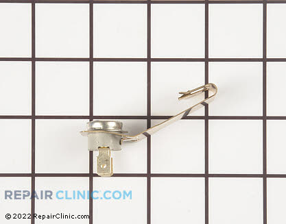

The only thing left is the PTC/Hi limit
that could be intermittent.
The element itself couldn't be intermittent, I don't think. Wiring harness could be, but not the most likely.

.   New ideas.  I was working on a washing machine recently with a sticky timer/welded contact, that I might have misdiagnosed as something else were it not for the help of these forums.  This morning I was doing my own laundry, and my Staber, which I love, hung up at the usual point where it very occasionally (read intermittent problem) does.  After ruling out the lid lock switch, I've surmised it is most likely the timer, but is so infrequent I haven't done anything about it yet.
.   While I was thinking about my Staber, I thought about the other washer, and was thinking about starting a general discussion in these forums on timers and why and how they misbehave.  Then these two Bosch Dishwashers came to mind.  I'm not sure they are both stopping at the same point, though they both have the same result of running too long.  I'm beginning to wonder if it could be the timer itself getting stuck at some point because of a welded contact or otherwise.
.    Given how infrequently they both do it, it would be hard to test.  If I replace the part, it would be quite some time before I knew if it was successful. Given that parts bought through this forum can be returned even after they have been installed installed, up to a year later, I'm beginning to wonder about trying it out.
