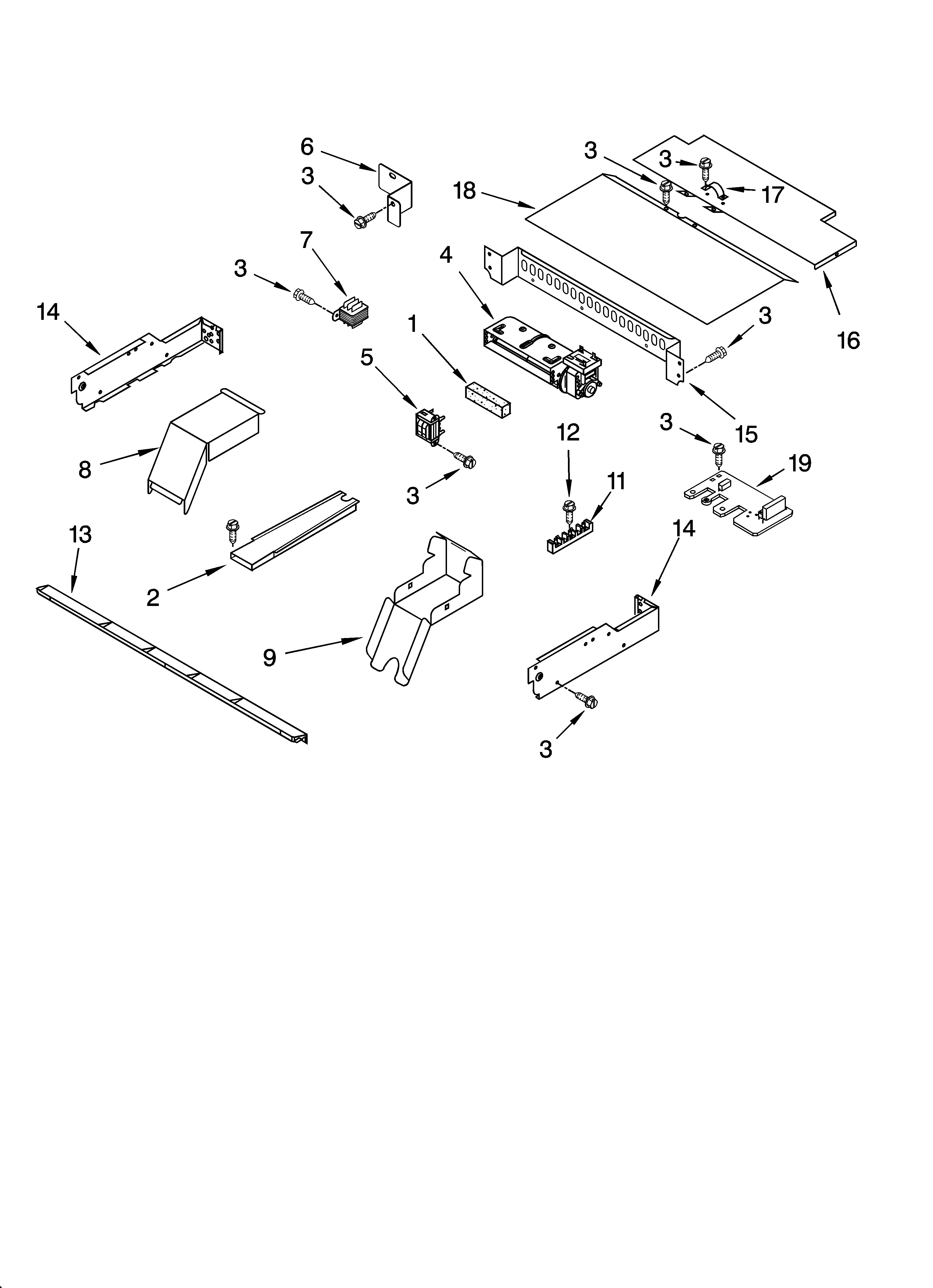

No oven light(s). Kitchenaid model: KEBC208KWH04
Our 5 year old dualing wall oven lights do not operate. I checked the resistance of all 4 bulbs and all measure 2.1 ohms. When I press the keypad switch, I hear a faint "click" meaning a relay is toggling.
Is there fuse and/or a transformer in the lamp circuit? Is there a way to extract an error code?
I am an electronics engineer so tackling the controller board does not scare me......when I have the time to get to it!

... I hear a faint "click" meaning a relay is toggling.
... or trying to ... may be bad.
have you used Self-Clean lately ? :nono:
Light Transformer # 5
Tech Sheet - 8302066.pdf
link PM'd
