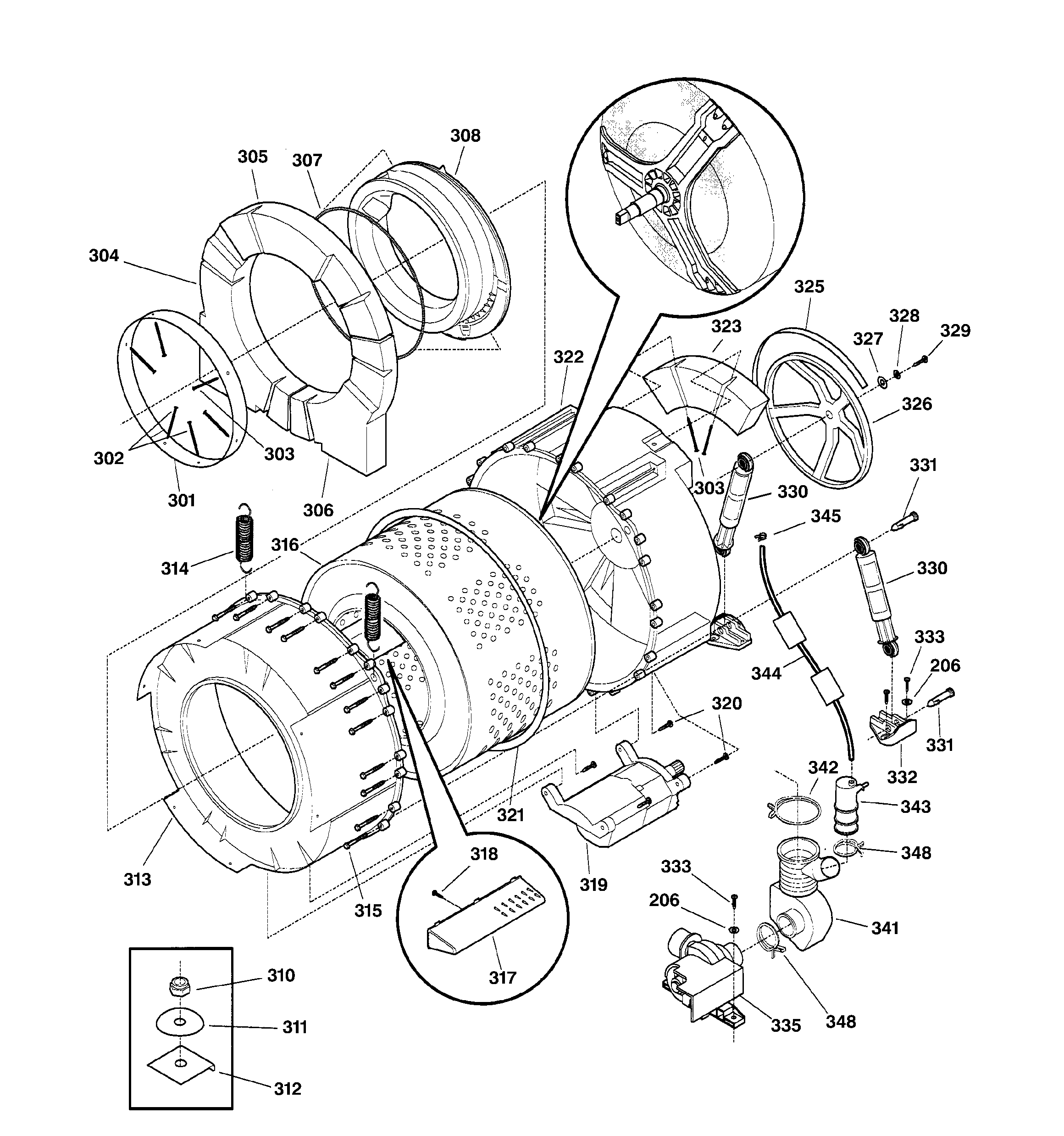

I have a GE wpxh214aoww that has a few problems. The first is recently I have been finding black grease looking stains on the clothes. The used to be small dots but now see more black lines/streaks. What could be causing this? The second issue is it has been making a noise when it spins. It starts as a squeak during the wash cycle but this gets much louder during the spin cycle. what do you think this is? Trying to decide if we should fix this or replace it. I like the machine and would rather fix if reasonable. Any advice/thoughts are appreciated.

thank you Master Reg. I didn't catch that one. Looks like a Frigidaire, pretending to be a GE. Does it make the noise during the spin? Kinda like a Jet engine?
I guess I should lay off the sauce. I just reread your post, more than likely your looking at an outer tub, and a spin basket, my advice would be to scrap it now and save your clothes, and the agony of this overpriced repair.

yes it is wxph214a0ww and here is a link to the noise it makes when i just spin it with my hand

doesn't sound good .....
may be the sound of death ...
:boohoo:
    Shōgun
  • 28,709 posts
Posted 28 December 2011 - 08:44 AM
Oh my, broken spider!
