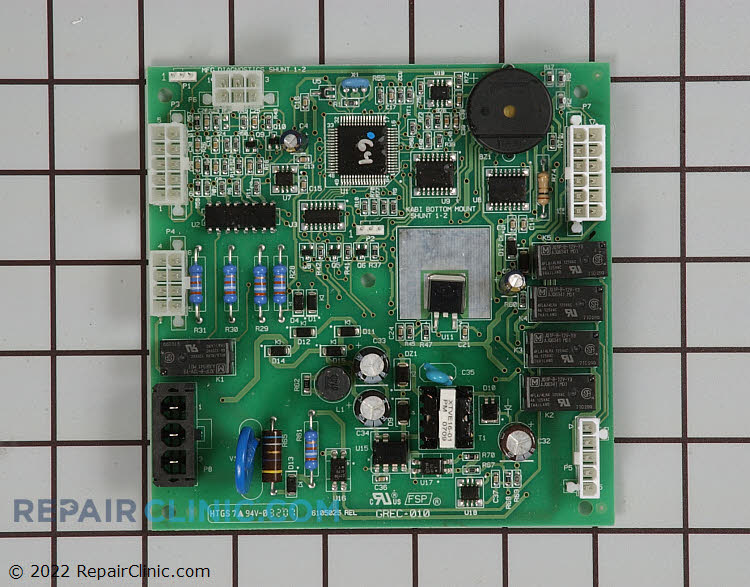

It won't cool the ref. side evap fan keeps pulsing when it beeps fan comes on.
It's not clear from this how long the evaporator fan pulses and whether or not it ever runs normally.
What are the freezer temperatures?
If the compressor is running, you don't need the inverter board so scratch that one off your list. ;)
Pulsing evaporator fan motor and not accepting keypad commands for diagnostic entry and self-test points to a bad electronic outta da box.
Part number: 2303934

Thank you Grand master...Evap fan comes on when beeping starts then goes off when beeping stops aproximately 30 to 45 secs.What does the Shunt do and why doesn't the new board come with one?
    Shōgun
  • Master Samurai Tech
  • 30,376 posts
Posted 05 January 2012 - 12:22 AM
And it will continuously cycle back and forth like this until the plug is pulled?
What's the part number of the board you're referring to so we can make sure we're talking about the same thang.

Board number is W10219463. yes evap fan keeps coming on and off when beeping starts and stops, also readout on interface numbers and lights flash but interior light doesn't even flicker.
#15 Samurai Appliance Repair Man
    Shōgun
  • 30,376 posts
Posted 05 January 2012 - 12:33 AM
Awwite, here's a purdy pitcher of the board. Where was the shunt on the old board?
Source ==> http://www.repaircli...0219463/1548001

Posted 05 January 2012 - 12:35 AM
Is there a way to IM you or can I call you? Whats a faster way to get in touch witcha?
#17 phydeauxe64
phydeauxe64
    Sōhei
  • Chief Appliantologist
  • 104 posts
  • Flavorite Brew:"Double D" Turbo Coffee
Posted 05 January 2012 - 12:41 AM
Top left corner above P3 is MFG shunt Then where the silver square is just left of that is the other shunt
If you read above silver square it says "KABI bottom mount shunt1-2
The old board had one there a little black thingy that plugs on to it
#18 phydeauxe64
phydeauxe64
    Sōhei
  • 104 posts
Posted 05 January 2012 - 12:45 AM
look left top corner of silver square with triac in it thats where the shunt was
#19 phydeauxe64
phydeauxe64
    Sōhei
  • 104 posts
Posted 05 January 2012 - 01:06 AM
Do You see where they are?
#20 Samurai Appliance Repair Man
    Shōgun
  • 30,376 posts
Posted 05 January 2012 - 01:16 AM
I see the location you're talking about. I'm not finding any info on the shunts, though.
