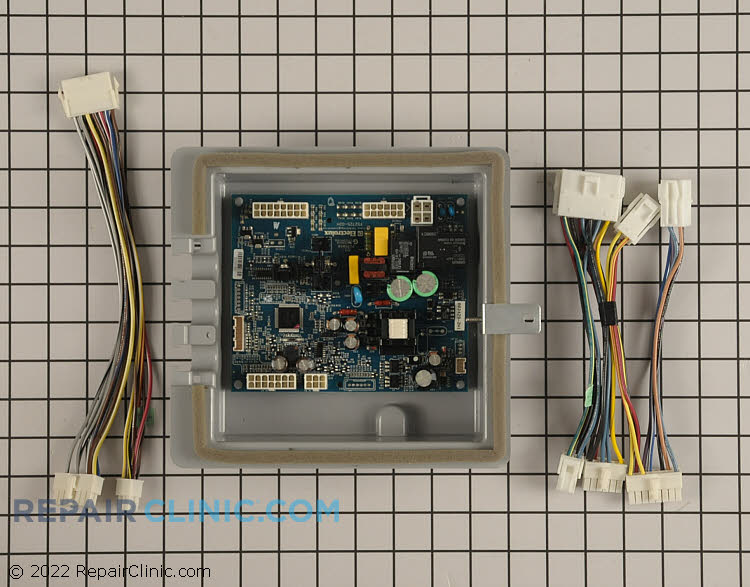

Ok, went out on the above refrigerator for a no cool complaint. Upon arrival I find freezer evaporator completely frosted up. I run diagnostics and find the defrost heater and the defrost thermostat working, I called the tech line and they say I need the main control board located behind the grille in the bottom of the unit near the condenser, All of the part look ups point to a 5303918523 which is a substitution for the original board. I follow the installation instructions and now I have a wire harness left over, I then plug in the refrigerator and absolutely nothing happens, no lights, no anything. So, either I got the wrong part in the right box, or a defective part. I hope Burnt Toast reads this since he is the Electrolux expert.

When I look at the board in the manual you linked too way way back in oct. It looks drastically different from this board.
Does the board in the pic look like the replacement board you have?
http://www.repaircli...mber=7241757001
came with all the wiring harnesses and everything?
This should be your original board below right?
I think you got a bad board out of the box myself.

Yes, the replacement board I got looks exactly like the picture above, and the old board looks exactly like next picture. I followed the instructions exactly, and nothing, no lights or anything. So I also think I got a bad board out of the box.

Update, the replacement board was defective, re-ordered and the replacement board was not compatible with the user interface (display board), had to order the display board, only to find out the hard way you have to hold both the up and down keys on the fresh food temperature adjustment to actually start the unit up.
On top of it all, I also had a defective evaporator fan, had to replace that as well. Now the unit is finally working like it is supposed to, $500.00 later. Customer is going to write a nasty letter to Electrolux about having to put $500 in repairs on a refrigerator that is only about 2 years old.
