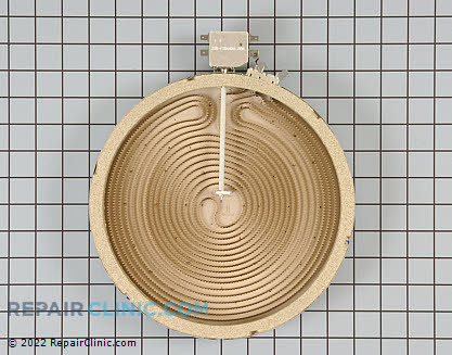

The element on the left looks like your dual surface element:
Radiant-Surface-Element-74008897--009936
The one on the right-- the one in question-- looks like your mondo element:
Radiant-Surface-Element-74008919--009936
The glow pattern for the dual element looks right. The glow pattern for the mondo element looks different from the ribbon element pattern shown in the photo. I'm not sure if this is just from sourcing a different manufacturer for that part.
At any rate, the exact pattern isn't as important as the fact that it is glowing. If it weren't getting the full 240vac, the element wouldn't glow like that. So it appears that the element is working properly.
Let's review the complaint again. How, specficaily did you determine or judge that the element was not heating up properly?

To me it looks like the outer ribbon of the MONDO element, (Samurai terminology), isn't powering up. It appears to be dual 6/8inch or 8/9inch element.
Common to both ribbons comes in thru the hi-limit/hot-surface indicator switch then you have two open terminal, (one being for the inner coil and one for the outer coil). The outer ribbon is burnt or the dual element infinite control switch is bad.

Domo for the analysis, Brother Willie! The ribbon configuration on the mondo element still looks incapable of producing the glow pattern in the photo, regardless of which ribbon is burned out. But I defer to the penetrating insight of the Willie Method.™
