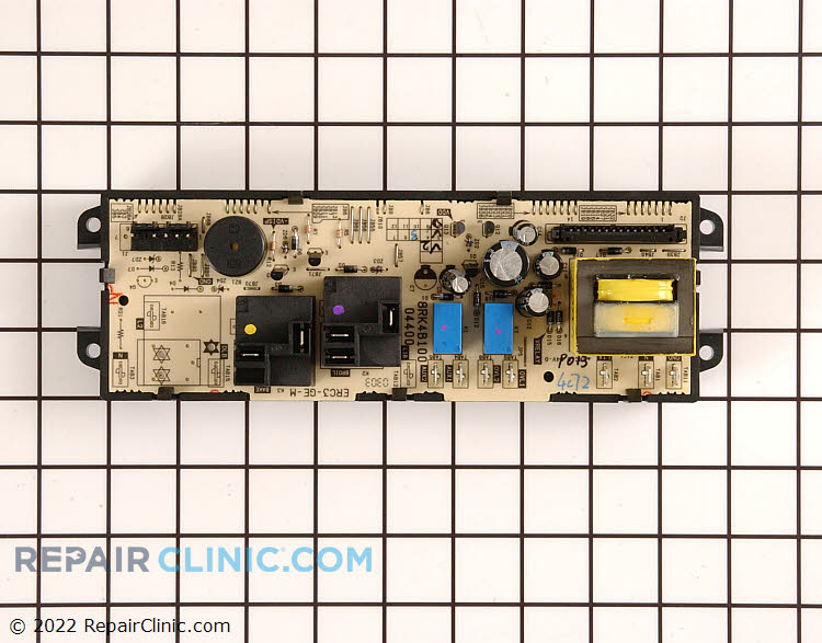

Broiler does not heat. Broil light comes on after pushing start button, but broiler does not heat. Which lead on control unit ribbon cable controls broiler? No error messages,

... Which lead on control unit ribbon cable controls broiler?
Relay with the Purple Dot
Did you test the Broil Element ?
http://www.repaircli...?R=154&N=832673
