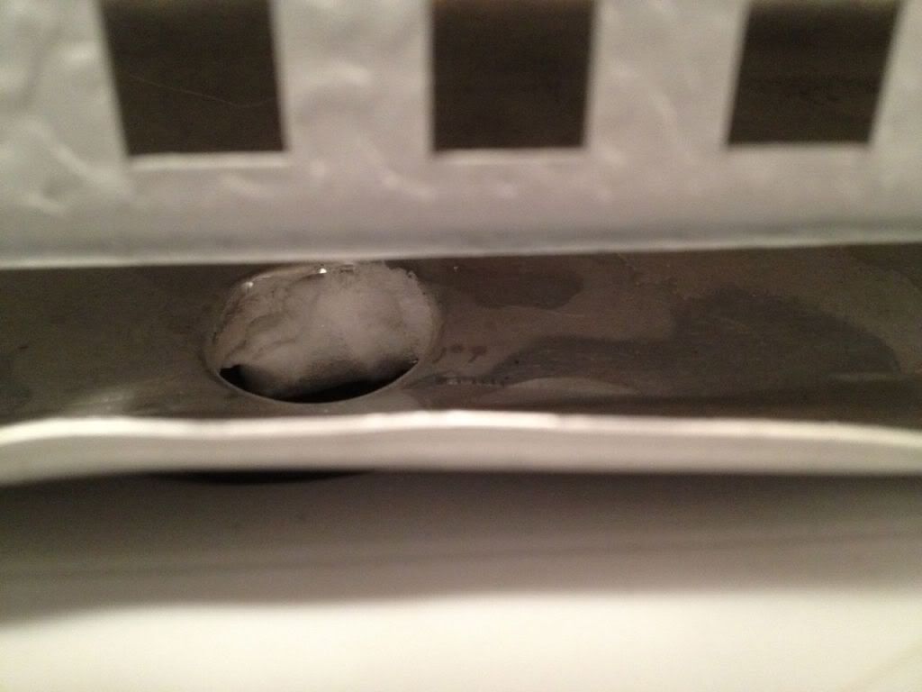

Last night I cleared out all of the ice from the bottom of my freezer, and also the drain hole under the drip tray, making sure the drain passage was completely clear again. After only 8 hours, frost started accumulating again at the drain. Attached is a picture of what it looked like this morning. The longer I let it go, the more frost builds, until it eventually completely ices the drain and clogs it. It seems to be accumulating after the defrost cycle, frosting as a result of moisture or a few drops of water left around the drain hole. Is this a problem with the heating element not doing a good-enough job of drying the water, or do you think the water is simply just not making its way to the drain hole passage? The passage is kind of tight in there... It's lined with rubber but is rather narrow. I tried making the opening bigger by taking a couple of screwdrivers and trying to expand from the top and bottom.Posted Image

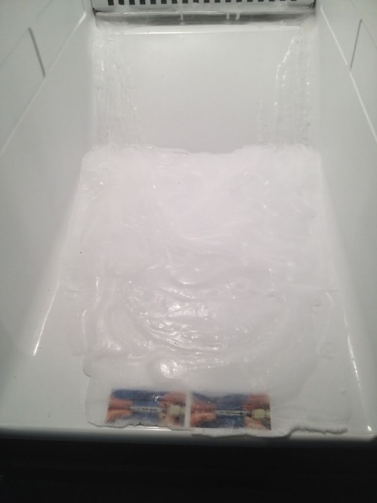

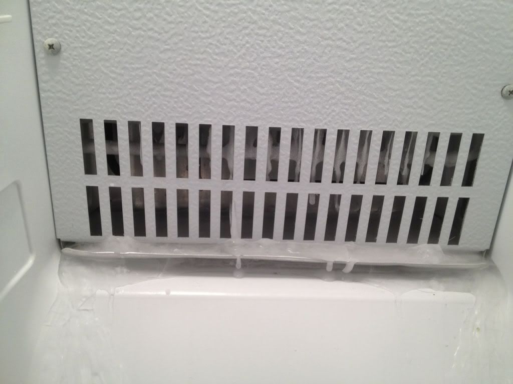

Here is what happens if the frost goes unchecked. Notice that the drain pan, as well as the entire surface underneath is covered with ice. It eventually clogs completely and then the water just runs to the floor of the freezer.Posted Image
Ice-covered floor:Posted Image

Looks like water could be leaking from icemaker and making it's way down there - disable icemaker and/or check all lines and the I/M mould carefully for leaks

Definate problem with drain termination in freezer section I would blow out drain or run hot water through it and clear obstruction!!! The heater strap is a great idea and would use it feeling confident your problems would be solved if not clogged with debris!!!!

Maybe y'all could tell me if things are operating properly based on my description: During what I am assuming to be the 'defrost' stage, if I look through the slats at the drip tray, I can see droplets of water falling from the coils above it. It's not a steady flow, it's just intermittent dripping. The water falls to the drip tray, and of course some of it goes to the drain hole. A handful of drops freeze onto the drip tray. Does that sound like proper operation?
