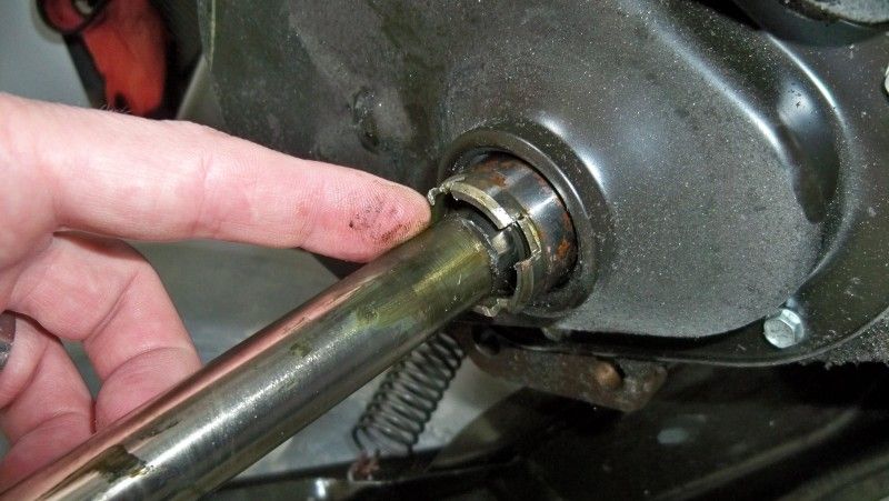

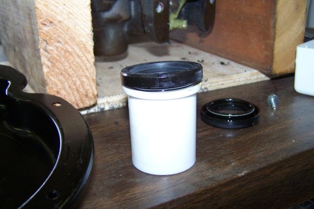

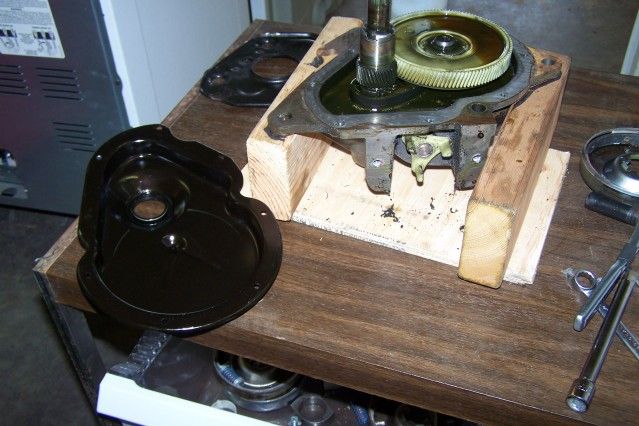

The shaft looks O.K.......The top seal is easily replaced.....Posted Image .....remove the cover.....Posted Image.......The plastic piece is 2" tail piece from a kitchen sink, matches the seal on one side to push out the seal and the other side will allow the seal to be seated evenly back into the cover.Posted Imageand install sidePosted Image...you do not need to beat the seal in just use windex and push firmly.............
P.S. forgot to add , use a thin coating of a good silicone sealant to reseal the cover

Kdog, that is not water leaking thru the upper seals that has made "The Ring of Sling", just oil from the clutch.
I've only seen one of two of the direct drive machines where the spin bearing were so worn out it had let water leak thru the seal and it makes much more of a gunky mess then what is being seen here.
The plastic cups and the gold pins were shipping pins that where installed when new to keep the tub from moving during shipping. When the machine gets installed and the yellow plastic rip cord is pulled it release the gold pins and they drop into the plactic cups to keep them safely out of the mechanism, (sometimes the cups fall off after years of use and you find the cups and pins on the floor and someone wants to know how to reinstall them - just throw them away).
The six pad clutch is more robust and will hold up much better on repeated overloading of the machine.

Forgot to answer your question about the black rubber/foam ring around the brake drum, it's just a sound deadner, don't mess with it, (I've never removed one but really doubt you would hear much difference with or without it).
As far as oil in the transmission, I really wouldn't worry about it. Just make sure the transmission is blocked up good and tight and level when you take the cover off and you shouldn't spill any more oil out. From the picture of "The Ring of Sling" you haven't lost enough oil to worry about adding anymore, (unless there was a large amound on the floor under the machine). Oil is filled up to the edge of the lower transmission case.
The heavy duty six pad clutch doesn't come with a new brake release lever, (if yours isn't broken you really don't need to replace it anyway).
As far as seals, you should only need to replace the cover seal, that is were the leakage that gets in the clutch comes from.
