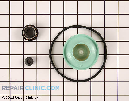

I don't believe it was just a screwdriver that was stuck in there to turn and free the stuck impeller.
I'm petty sure it's a 7mm or 8mm nut driver, (the plastic impeller has a nut molded onto the front of it).
Impeller and seal kit, (you can kind of make out the molded nut end on the impeller):
http://www.repairclinic.com/PartDetail/Drain-Impeller/167085/935404

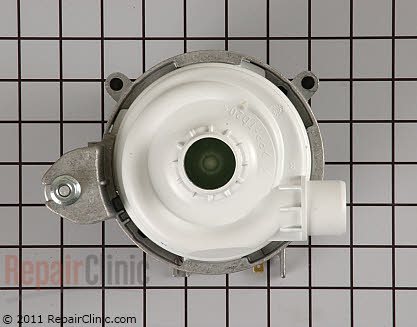

You most likely need a complete new motor and pump assembly if it locked up that quick again, water has most likely got into the motor bearings.
http://www.repairclinic.com/PartDetail/Circulation-Pump/239144/1042021

That pump is the heart of the machine. Replacing it is almost like getting a whole new machine in terms of operation. Its running at 150 bucks from repair clinic, WHICH IS A STEAL!!

When a Bosch motor hangs up and buzzes, first think I ask is when did it last run? Sometimes suprisingly they say, Oh, a couple months. Really? Well when the seals dry up they stick. And these motors dont have that much startup torque so instead they just buzz.
So you take off the LH cover, get access to the motor and I always use a wooden push stick to dislodge the motor since I cant always kill the power. But if it happens again within a few weeks, man you gotta gey yourself a new motor. Your bearings are getting to shot.
