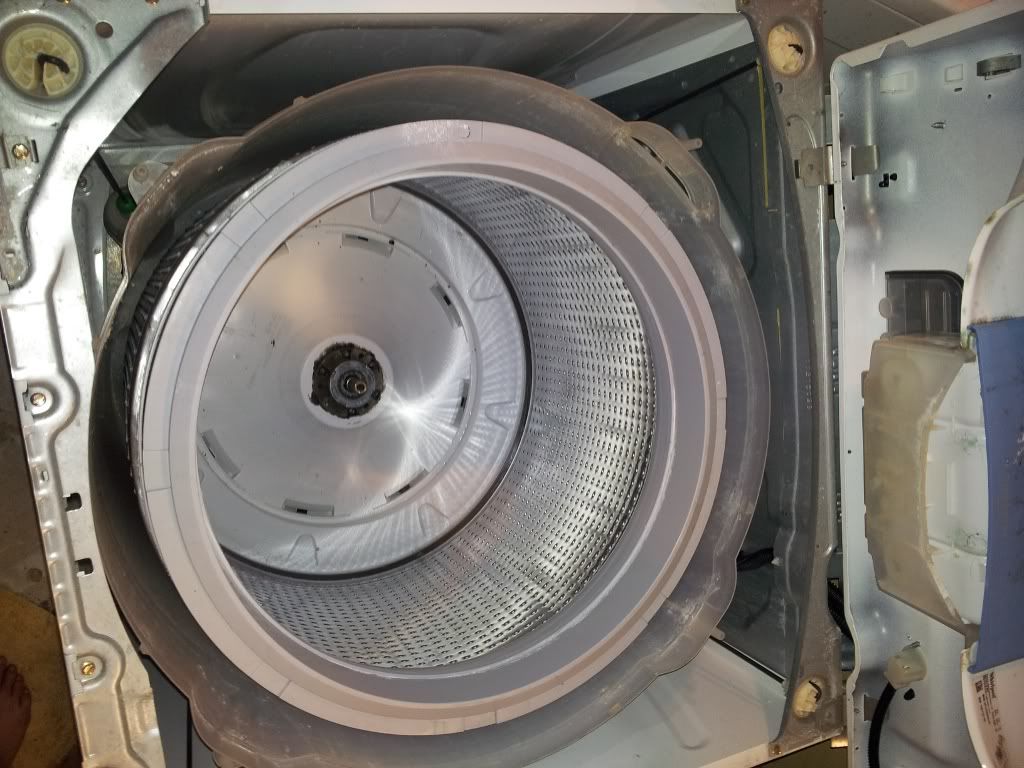

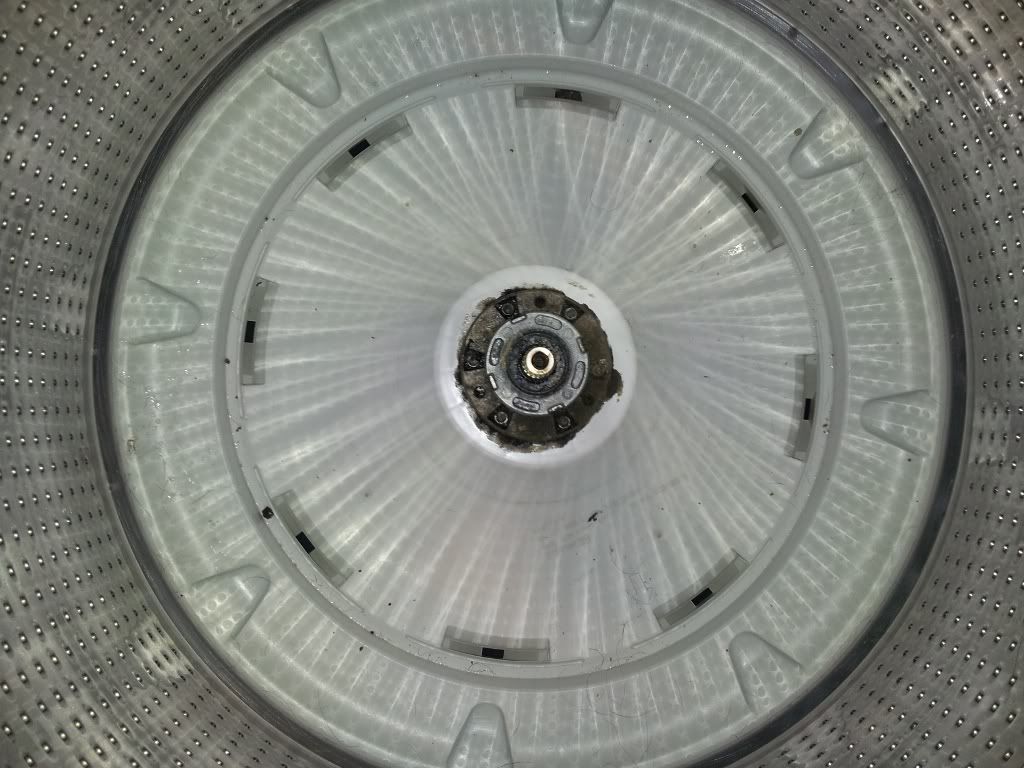

Now that I have the top off how do I remove the inner tub. See the picture, there is a center metal hub with a brass splined shaft sticking up. I removed the six philips head screws but how do I get the hub to release from the shaft?
This is the hub.

#7 Mr_Rich

#8 nickfixit
nickfixit
  • 1,965 posts
Posted 08 April 2012 - 01:55 PM
This isn't the normal Cabrio, this is the new version that is not a direct drive and lacks a recirculation pump. The proper removal of the top involves taking the hinge screws and other screws off the back and pulling the top forward a bit than up to clear a tab on each side. IMO it's a stupid design
The basket is removed by removing the spanner nut, its that galvanized thing maybe 2.5 inches in diameter just above where you took the 6 screws out.The original whirlpool direct drive spanner wrench will work or use a punch and hammer.
Put the 6 screws back in the basket hub before you try to pull the basket.
  • I wish those shit heads at Whirlpool had not called this a Cabrio...it's confusing the customers, salespeople, and service staff too.

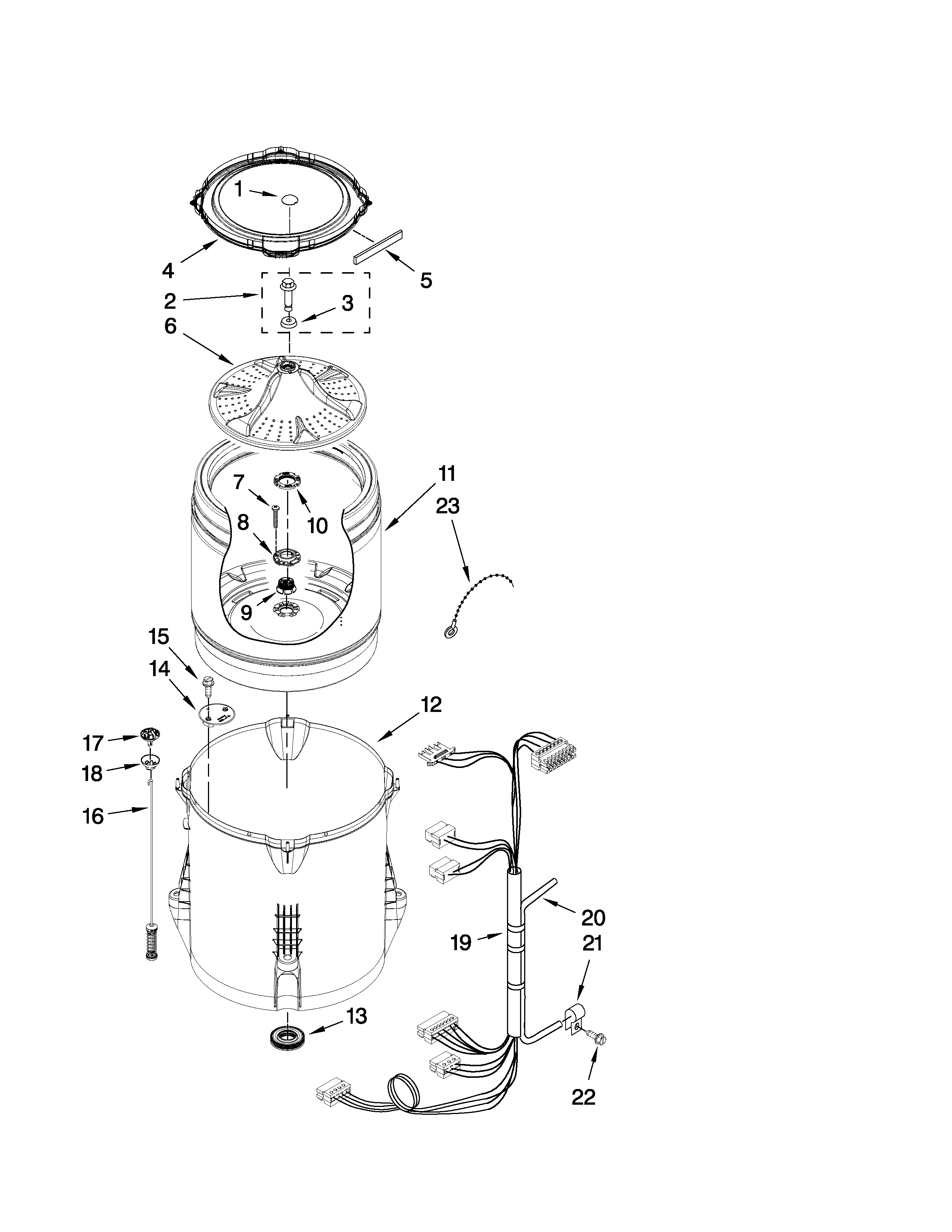

#9 RegUS_PatOff
  • 30,229 posts
Posted 08 April 2012 - 02:48 PM
# 7 Screw
# 8 Driven Hub
# 9 Basket Block
# 10 Spanner Nut
included in kit W10324651 $ 31
http://www.repaircli...R=154&N=1877235
more info:
http://appliantology...se-replacement/
#10 Mr_Rich
Mr_Rich
  • 10 posts
Posted 08 April 2012 - 09:50 PM
Thanks Nickfixit and RegUS_PatOff. I'll try this tomorrow night after I replace the six screws.
After I forced the top off I relized it would be removed by taking out the two pieces from the back and sliding it forward. No damage a little touch up paint won't fix..
Rich

#12 Mr_Rich
Mr_Rich
  • 10 posts
Posted 09 April 2012 - 09:03 PM
I still can't get the stupid tub out. I removed the spanner nut but cannot get the tub loose. I read the attached link but I concerned with dropping the transmission out of the bottom.
I've held the inner tup up and beaten the splined shaft with a hammer and block of wood with no movement.
Does anyone have any more advice?

#13 sh2sh2
sh2sh2
    Sōhei
  • 211 posts
  • Flavorite Brew:yeunling
Posted 09 April 2012 - 09:09 PM
i have had trouble with getting these tubs out before. i take the screws out and take off the top piece of the hub, then repeatedly pull up on the basket after spraying some oil on the shaft...makes me scared of when these machines are older...all corroded after 6 months to a year
#14 Mr_Rich
Mr_Rich
  • 10 posts
Posted 15 April 2012 - 07:47 PM
That was the ticket. I got it apart finally and found bobbie pins artially jamming the pump. It must have been erroring on pump out.
