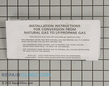

#9 RegUS_PatOff
  • 30,299 posts
Posted 05 April 2012 - 10:02 PM
L0205223.pdf :whistling:
INSTALLATION INSTRUCTIONS FOR CONVERSION
from NG to LP / PROPANE
and from LP / PROPANE to NG
... need Orifices:
(2) 107N
(2) 150N
(1) 180N
(available from local appliance parts stores)

#11 RegUS_PatOff
  • 30,299 posts
Posted 05 April 2012 - 11:03 PM
... So the PNs you provide are the LP orifices. Any idea on what the hole size is for either the L/P or NG?
from PDF page (1)
LP Orifices:
61L
87L
97L
from PDF page 4
40" Duel Fuel
NG Orifices:
107N
150N
180N
#12 icarus
icarus
  • 9 posts
Posted 05 April 2012 - 11:15 PM
I noticed the PN for L/P and NG in the instructions. Do the PNs relate to drill size or decimal size by chance?
Perhaps with those PNs I can find a set of NG orifices.
Thanks once again,
Icarus
#13 RegUS_PatOff
  • 30,299 posts
Posted 06 April 2012 - 12:24 AM
from some on-line searching,
ORIFICE
61L = .61 mm
87L =.87 mm
97L = .97 mm
107N = 1.07 mm
150N = 1.50 mm
180N = 1.80 mm
