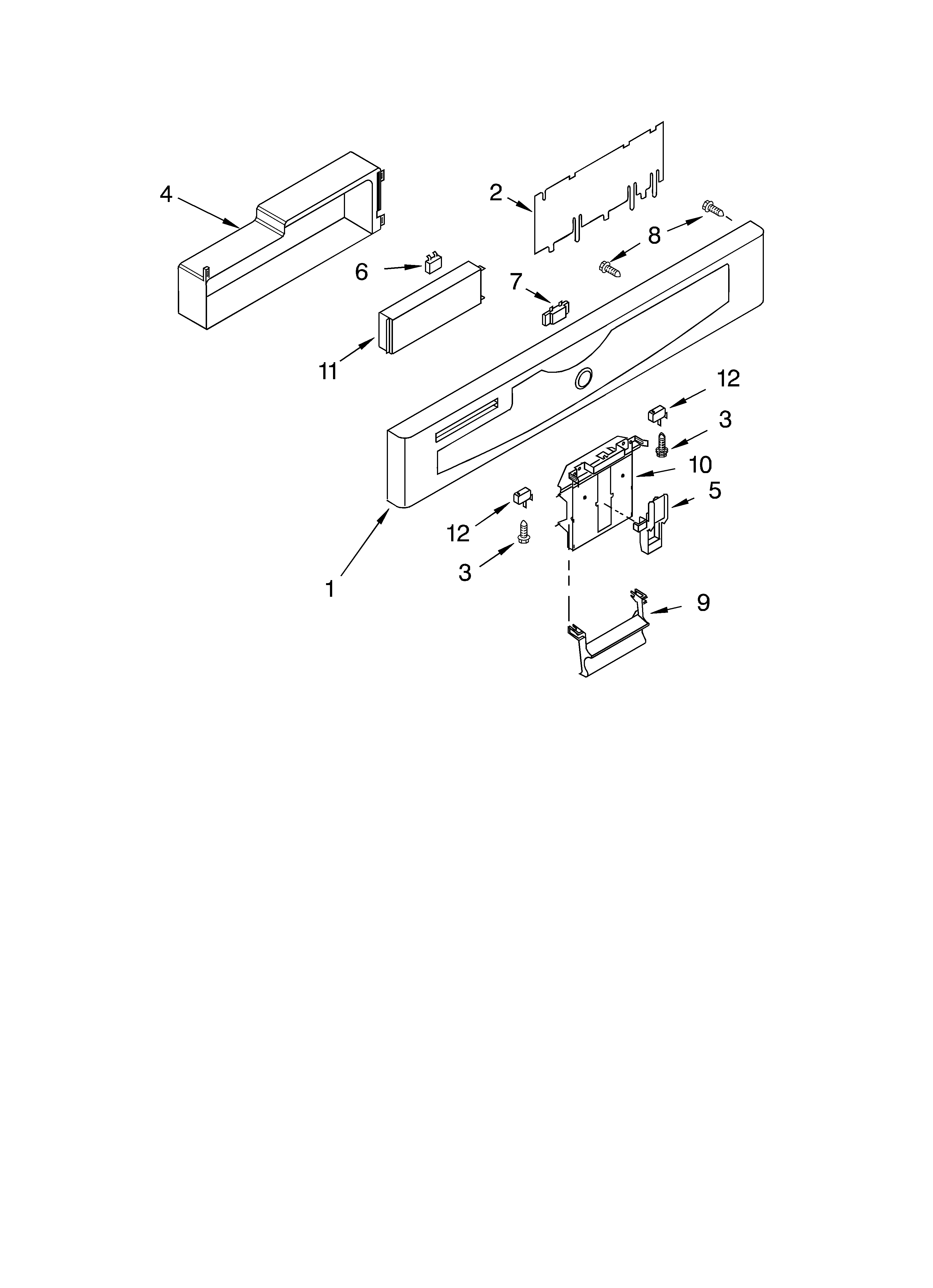

someone with an OHM meter could test the Door Switches,
may need to remove the Door Panel to access the Switches.
The stainless steel Tubs use one Door Switch,
the plastic Tubs use (2) Door Switches (# 12)
The affected Switch will Have a Tan Wire and a B/W wire

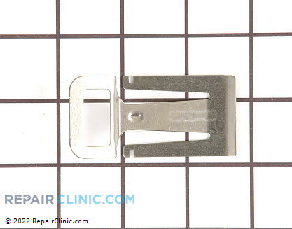

The Door Latch assembly that holds the Switches, may be damaged / skewed
OR the Door Strike / Actuator may have become bent / dislodged from the Cabinet / Counter Top
