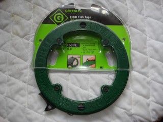

Joan Crawford in Mommy Dearest
"NO WIRE HANGERS, EVER !"
Okay Already! Lay off the coffee, mom! I actually use this :
Edited by DurhamAppliance, 09 April 2012 - 10:27 AM.
