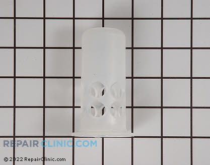

There is a plastic filter between the tub and the pump inside the rubber hose, unless it's been removed. Does the pump run? Does the machine make any noise when it's supposed to be draining?

I stuck my fingers up in the rubber boot, into the tub and didn't find any filters in my model. I can hear the pump running and if I put my hand on it, can feel it as well. Also, according the the Mrs. the drain/spin option isn't working either.
