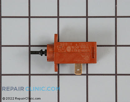

. Here is the inside $70 switch part no. 131763202:
but you may not NEED that, though it is broken.
. Here is the one I fixed in the link above for $12 bucks:
[see image in next post]
That little white thing that the screwdriver points to is the wax motor which you can replace if everything else works OK in the switch. That is what moves it over to lock.
See here is the piece that tells it "I'm locked, go ahead and spin, because nobody can get his/her arm in here now."
The white wax motor pushes the black thingy, where the screwdriver is pointing, into the lock mechanism, it may push it far enough to lock it, but when it does, it also needs to push the two copper contacts together just to the left of the screwdriver so the compuker knows its locked. It won't, by the way, do any of this, unless it knows the door is closed, which is another set of contacts in there, though I don't know which ones, as I don't have one of these in front of me right now. Anyway, it is so beautifully and simply mechanical in there, you can figure that out pretty easily.
. So should you see everything in there is happy, which I'm sure it is, you need this:
Part # 12002535 $12.
The housing on the door lock opens VERY easily. It's easy to put this in, and easy to test the door lock itself.
. One problem left: as for Mamma-San, tell her you are getting a real education, through real experience! You are sharpening your analytical and problem-solving skills. You are increasing your virility by doing man-stuff. You'll feel very satisfied by accomplishing this, and she will too from your increased virility. Shipping costs?! I don't know where you live, but a repairman might charge you $90, just to walk through the door, and tell you "Looks like you need a new one" which often really means, "I can't figure it out." If does fix it, more bucks for the labor time, plus he'll probably double the price of the entire switch assembly that you don't need. So $140 for the switch, $150 for labor. Oh and did you need the pump? Another $150 or more? Well over $400, anyway, and you wouldn't get to have all this fun.
