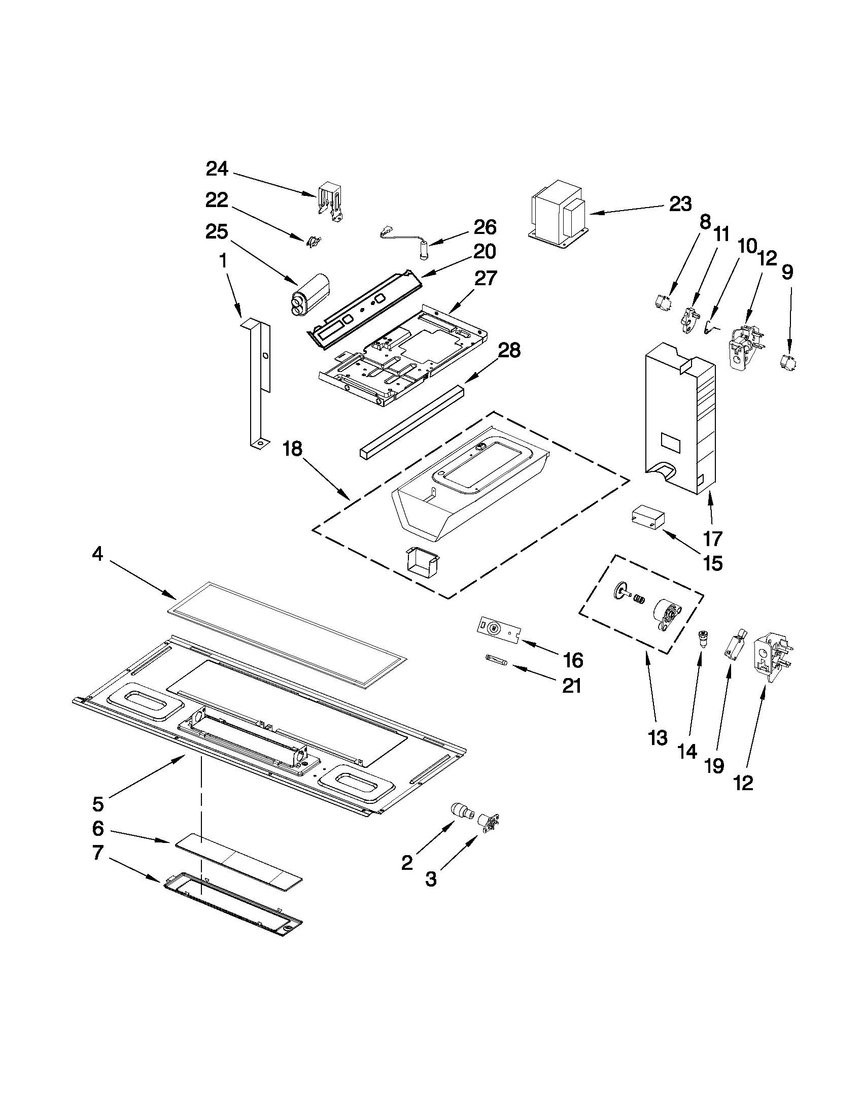

Whirlpool model WMH1164XVS2 turntable spins constantly when the door is closed (tuns off when open). When attempting to program a cook cycle, the display reads "Door Not Closed" or something very similar.

... Whirlpool model WMH1164XVS2 turntable spins constantly when the door is closed (tuns off when open).
... When attempting to program a cook cycle, the display reads "Door Not Closed" or something very similar.
Has this worked OK up till now ?
1) Secondary Interlock Switch (wrong Switch or Latch Interlock not working)
2) Primary Interlock Switch (wrong Switch or Latch Interlock not working)

Yes, this unit was working until this point. I check the switches continuity and they seem to function properly when opening and closing. A switch would explain the light issue but isn't the turntable motor activated by the control board?

... A switch would explain the light issue
what Light issue ?

the switches control the turntable also, order all 3 Parts 8,9,19. one of them is bad, I usually replace all 3 when 1 is bad just to keep from having a recall.

Oh, sorry I thought that was mentioned.  With the door closed, the light comes on AND turntable spins

... and the Light is ON when Door is "open" or "closed" ?
bad CL Relay on the Controller Board .. OR other circuitry on the Controller is bad
(also controls the TurnTable Motor)
Part number: W10211457

Yes Comstock, switches test out so I pretty confident it's the CL relay on the circuit board after reviewing the wiring diagram.  At $140  for the part, this unit isn't worth the repair.  It is now an organ donor.  Thanks for all your input and the diagram.
