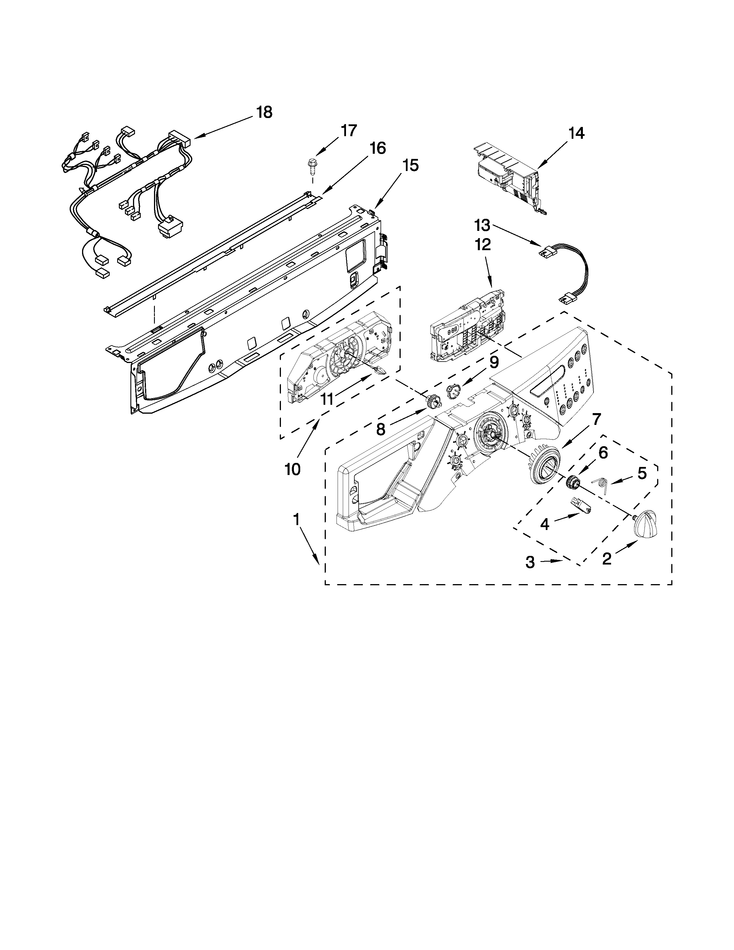

Hey Applicance Pros!
I've got the F70 problem on my Whirlpool Duet. I've read another similar problem on this forum about the CCU & MCU being faulty and noticed you provide great advice to rookies. I then proceeded with testing according to the technician sheet inside the machine. I thought it was a faulty CCU and replaced it but the code didn't go away. I then tested with M13 connector unplugged and the code didn't go away. Can you tell me what to do next? The drum rotates (manually). Do I need to replace the user interface?
Thanks.

3. If the drum is not rotating, unplug the MCU from the CCU (the MI3 or M13 connector).
If the code goes away, then replace the MCU.
If the code does not go away, replace the CCU.

From I can see, there is some confusion with the parts. I asked Whirlpool for a CCU and they sent me part # 14 on this diagram: http://www.whirlpool...219/i441585.GIF - which is what I replaced.
The CCU link on the repair clinic site shows a photo of the center & right user interface. The repair clinic site has 2 Main Control Boards listed for this washer model and only 1 has a photo. http://www.repaircli...-Or-Timer-Parts
So should I replace the user interface now?

Can you please do us a favor? The parts link you have listed above for the CCU is actually the user interface, this did confuse me and it might confuse others. That's why I asked Whirlpool for the CCU and not the user interface.
Regarding the user interface, is there a testing method to determine which interface (center or right) is faulty?

I don't think it really matters, if you look-up the parts you will find that the center interface board part# w10164402 comes up as No Longer Available.
If you look-up the right user interface board part# w10191964 it changes to kit part# W10319813 which includes both boards.
