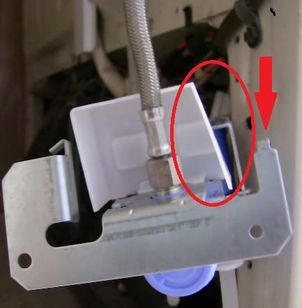

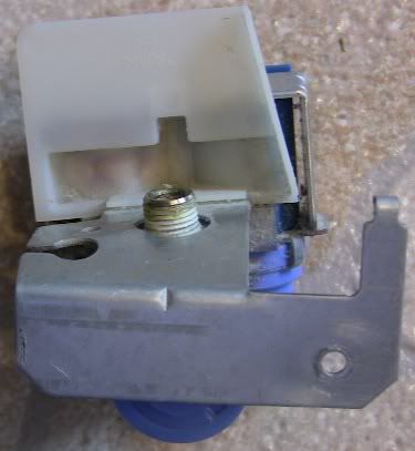

OK, so I declared victory just a tad too early. When trying to put it all back together, I noticed that the shield/cover around the water inlet is much larger than my original one and doesn't let the valve to hang flush on the frame to be screwed back in.
new valve: Posted Image original valve: Posted Image
The "Tim the Tool Man" in me says to grab a cutting plier and cut down the plastic and make it fit. What am I missing? Thanks.

Posted 23 May 2012 - 10:44 AM
that plastic shield is easily removed.pull back on it with your hands,should pop right out.place shield on floor and repeatedly jump on it with gusto,while cursing ge fridges goes a long way to making you feel better.

Posted 23 May 2012 - 01:35 PM
Tommytech, thanks for the simple advice. Jumping on the plastic shield was not nearly as satisfying as knowing it was the water valve and not the ice maker that was broken!!!
