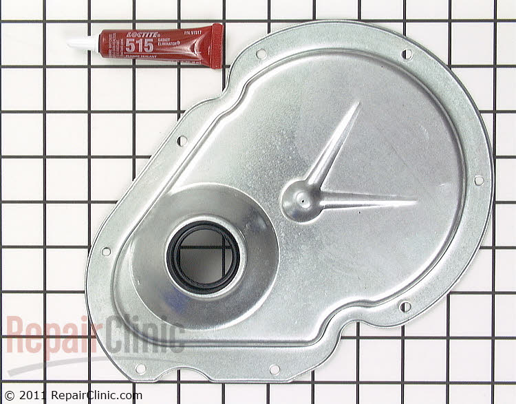

I had the machine, Kenmore 70 series, upside down while moving & some trans oil leaked out. I'd like to add a little without taking everything apart. I read I can use a syringe to add some through the trans. vent hole. Where is the vent hole? I assume it's on the top of the trans. case. Standing at the front of the machine, would it be to the left, right, front or back or some angle in between? Any other help will be greatly appreciated. Pictures? Thanks in advance. Tony5657 in TX (My 1st post)

how much oil actually leaked out ?
I don't think any Oil will flow into that Vent Hole (center of "V") very quickly...
1 square = 1 inch

Thank you for your fast replies. This is my 1st attempt to do anything to a washer. I estimate about 2 ounces leaked out, not much. Thanks Grand Master for sending the picture!
Removing the trans. appears to be really complicated. Since the transmission case is still mounted, I'll feel around and try to locate the "V" and the vent. I'm thinking about jacking the washer up in the upright poisition so I can work under it. Then the vent will be in the "up/normal" position. Then hopefully I can figure out how to get a syringe with oil up to the vent & add some, IF necessary. If you think I need to add oil, will 90W straight mineral oil work? I have that in my 1956 Thunderbird overdrive transmission. OR should I use a more modern 90W automotive differential/rear end oil? If so, which one?

Personally, I think you're going through a lot of trouble for nothing.
If only an ounce or two of oil leaked out the vent hole on the top of the transmission cover from laying the machine on it's back for awhile you shouldn't have any problems.
My personal opinion is that these transmissions are very strong and durable and could probably be ran almost dry of oil and still work for a very long time, (I believe a full transmission holds about 16 ounces of oil).

"... the Gearcase with 12 to 15 ounces of S.A.E. No. 60, non-detergent motor oil ..."
