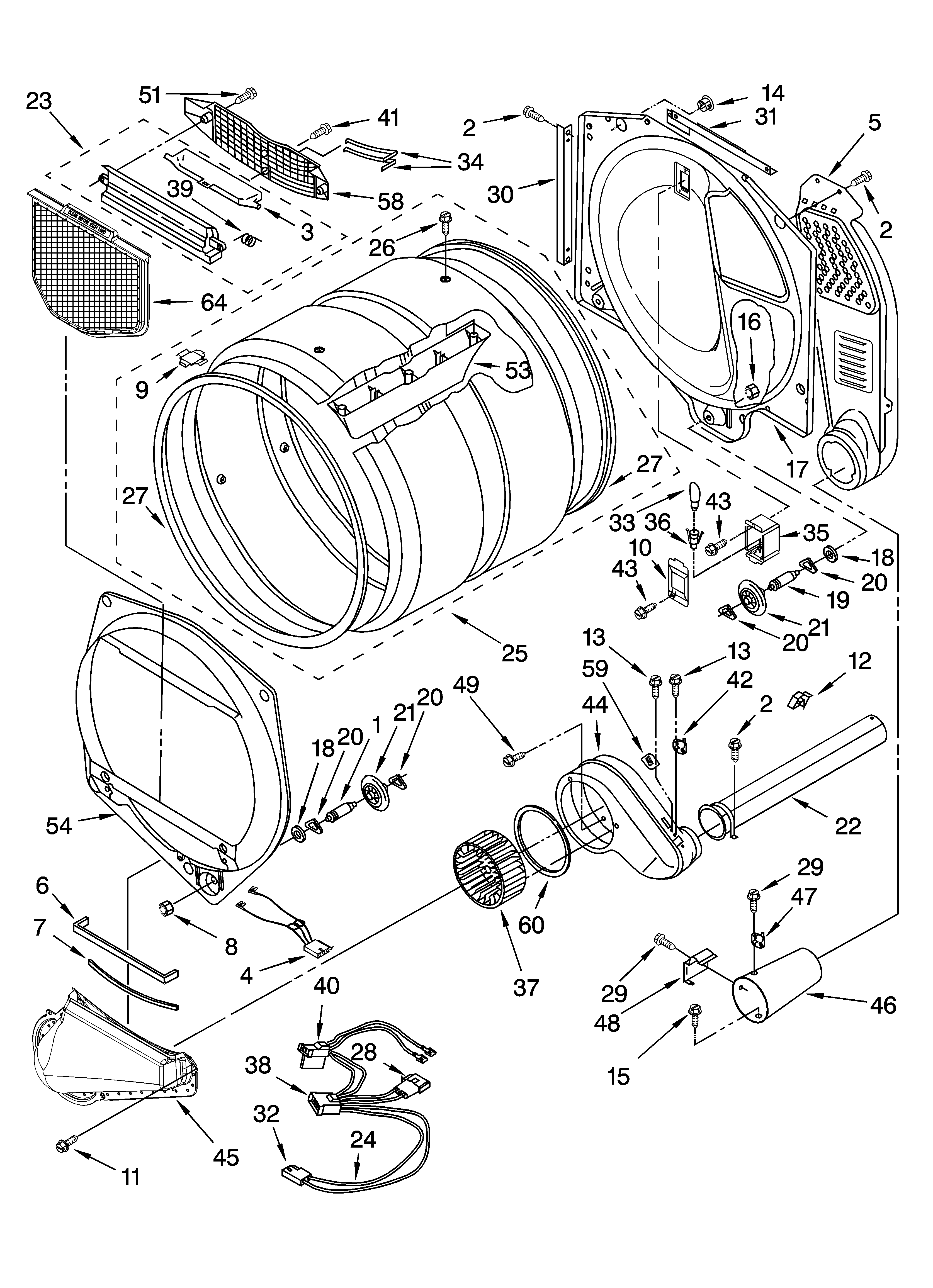

Our Duet Dryer just started making a clicking noise while it runs. Its a constant fast click, like if a card was stuck in the spokes of a kids bike and the wheel was turning very, very fast.
I took the bottom plate off, but couldn't see anything obvious, sounds like it's coming from inside the galvanized metal capsule secret compartment (with no seeming way into it).
Anyone know what this is?

This is the filter chute/blower cover...should be 3 or 4 screws holding it on. Look carefully around the perimeter of the capsule.
prolly something in the blower...

model number for possible diagrams

GGW9250PW1 -- thank you a diagram would be awesome.

nice! so you think I have something stuck in part #37? That would make sense considering the shape of that part and the speed of the clicks I'm hearing.
Gotta be a coin or something.

That is the right place to start looking.
