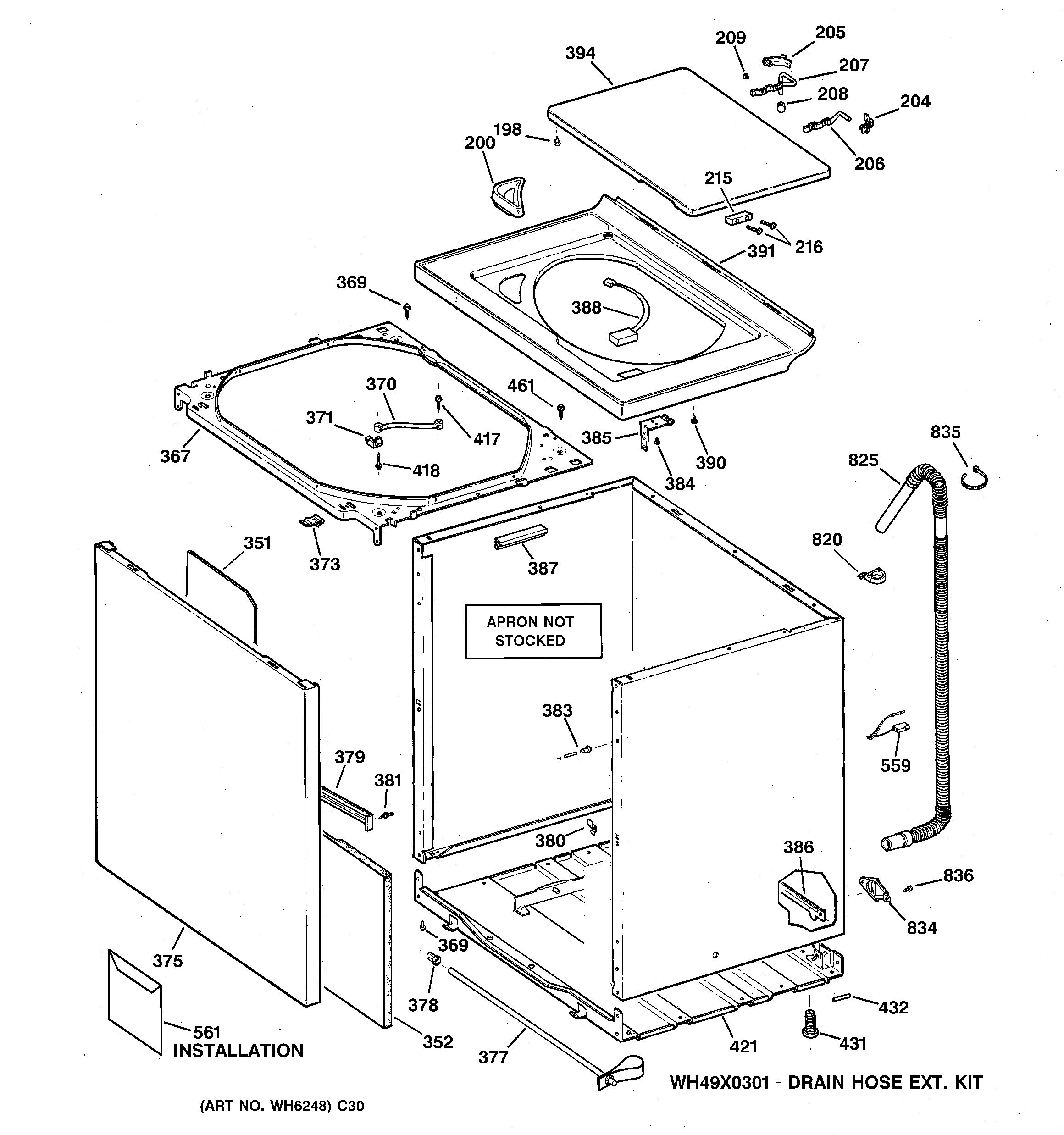

Ge Profile washer Model number WPSB8060B9WW. Washer will not drain, just buzzes when it reaches that part of the cycle and I am pretty sure the pump is the issue. The more pressing issue is how do I get it apart ??
    Your Sometimes-Lucid Host
  • 24,321 posts
Posted 25 June 2012 - 07:39 PM
Part link to the pump ==> http://www.repaircli...er=WPSB8060B9WW
Remove the front panel and it's right there. Use a putty knife to push in the clips at the top of the front panel, about an inch from each end.

That is what I thought but how do I get the front panel off ? Is it held with clips ? I tried prying but do not want to force it. Thanks

Still struggling here. Do I need to remove the top first ? There is definitly something I am missing. I removed the control panel as that seems to hold the top but cannot get the top nor the front off.

... Use a putty knife to push in the clips at the top of the front panel, about an inch from each end.
Clips # 373 Left & Right
  • 24,321 posts
Posted 25 June 2012 - 09:00 PM
Posted ImageClick for large view - Uploaded with Skitch
