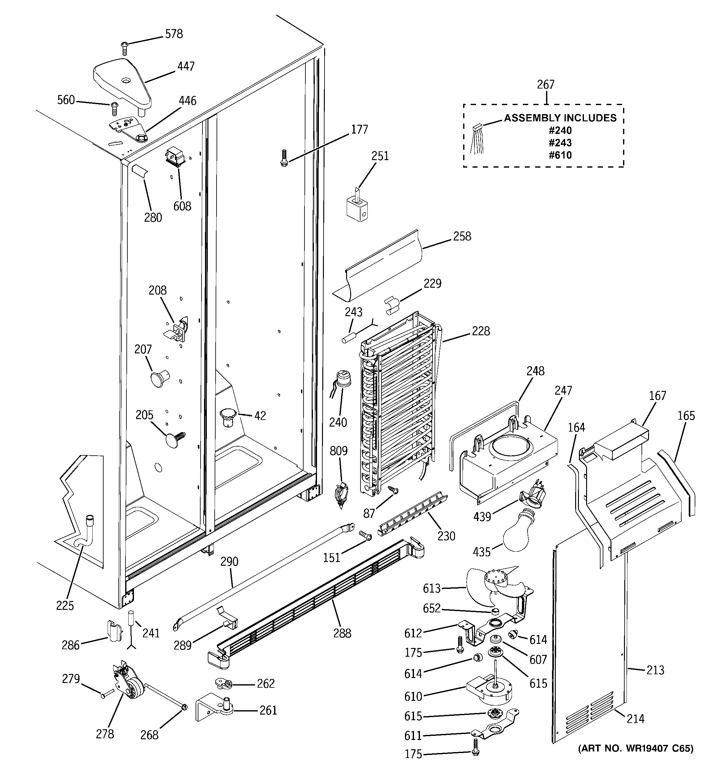

To get at the freezer evaporator, it appears I'm going in from the front? After removing the ice maker? I'm already envisioning selling this thing for parts/repair and buying a running used one. This is for a rental and it's feeling like a wash to either put umpteen hours into the thing or lose a hundred bucks or two to replace it.

OK, just cruised craigslist for a replacement and if I can get this thing running it's worth it. Let's talk worst case scenario. I take it apart and the frost pattern is zero. No coolant? Leak? Then we have to find the leak? Then find out if the compressor is good?

#12 Randini
Randini
    Ikkō-ikki
  • 28 posts
  • Flavorite Brew:Cowboy Coffee
Posted 07 July 2012 - 01:55 AM
That's the pic I found that made me want to bag this thing.
Sears says they'll come fix anything up to $500 in parts and labor for $250+tx and warranty it for a year. Anyone had experience with this? Seems like the likely gotcha is they're billing Retail and the tab could easily go over $500.
