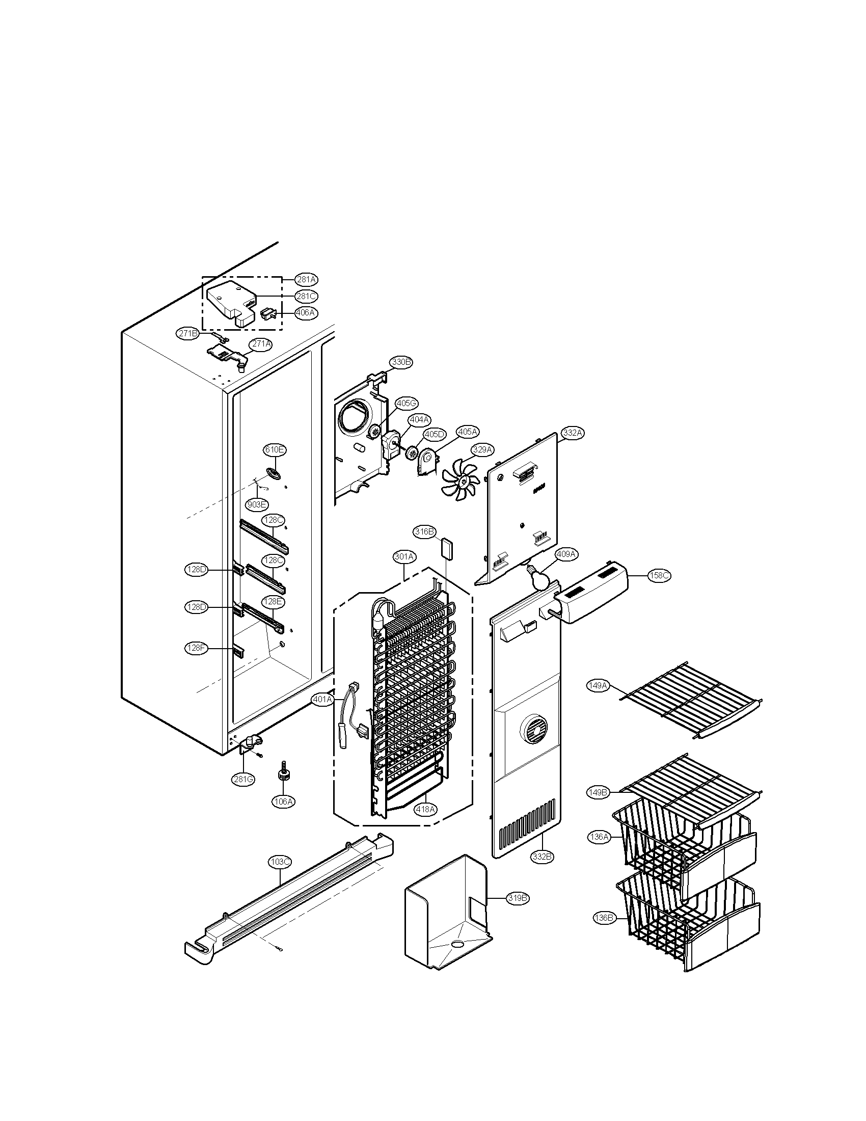

I'm down with the Flu right now and low and behold my LG side by side give an error code today "Er FF". By most checks, it says it is a freezer fan problem. I saw something as simple as unplug the refridgerator for 3 hours, let it melt and it will be fixed!!
Even though I feel terrible, my wife will call someone if I don't take a look at it this weekend. I have been hearing the freezer fan rumble for about a week. When you open the freezer door it stops but usually starts back a couple of minutes after the door is shut. In addition to this I have had an ongoing problem for about 6 months where the icemaker does not work as well as it usually does and you have to pull out the tray and break off a big "stalagtike" of ice that forms underneath the tray. I guess it leaks when it feels and over time that builds to a 2-3" piece of ice. I'll post the photo today but the formation is really small right now. I would love to fix both problems.
I assume this Er FF code means the fan is no longer able to run. What can I do to fix this thing quickly? Can I remove the ice make and let it thaw out and stick it back in? Is there a repair manual that is downloadable for this model?
Many thanks,
"stalagtike" is starting to form almost in the middle of the picture.
Edited by plsbcheap, 06 July 2012 - 02:22 PM.
#2 RegUS_PatOff
  • 30,278 posts
Posted 06 July 2012 - 02:36 PM
... LG side by side give an error code today "Er FF".
... I have been hearing the freezer fan rumble for about a week.
... icemaker does not work as well as it usually does and you have to pull out the tray and break off a big "stalagtike" of ice
... repair manual that is downloadable for this model?
1) yes, Freezer Fan error
2) "rumble" could be bad Fan bearings OR if Evaporator not defrosting, Fan Blades could be hitting frost / ice
remove the Eavporator Cover, and take a look at the Evaporator Fan
3) would seem to be a water leak ...
4) what model ?

Evaporator Fan # 404A

I got the freezer cleaned out, then the ice maker removed and took this picture. I see the fan and assume the 404A in the diagram is the motor behind that fan. Does the error code tell us for sure the motor is shot? Or is there a way to test the motor before I replace. I don't know much about refridgerators but I'm now assuming the freezer generates the cool air for the refridgerator so I am screwed for the weekend unless I can get that motor fixed or replaced tonight or tomorrow morning.
I'll focus on the ice maker buildup issues after the freezer runs again. What all needs to be removed to get the fan out?
thanks,
can you give me the diagram in pdf, (full parts descriptions)? I should probably look up 405A, 406 etc.

Evaporator Fan area may be similar to LG LSC26905 Service Manual
http://appliantology...service-manual/
    Your Sometimes-Lucid Host
  • 24,347 posts
Posted 06 July 2012 - 07:07 PM
Nice pix, as always, plsb!
Here's the link to your evap fan motor ==> http://www.repaircli...JB1029A/1330410

Here is my Saturday afternoon update and some steps of how to replace the motor (Evaporator Fan). Somewhere I saw the part number was replaced by a 1027A but after some research it looks like the original part number 4681JB1017D was replaced by the manufacturer with part number 4681JB1029A.
First, take out 4 screws and remove the auger that turns the ice bin (I am assuming you took the ice tray out already). Unplug the wire harness. Then take out the top left screw (into the ceiling) for the ice maker. Unsnape the wiring harness and kind of wiggle the whole assemby back and it will slide right out. Next take this bracket off the wall for ease of taking everything else out. I forgot to take a picture before I removed the back way so just imagine there is still a back wall there... :-)
Now the rest is weird. All the plastic feels like it is going to break with any slight twist. There is a center screw in the plastic wall (that hides the evaporator fan). After removing the screw kind of bow in the wall to the middle and pull in on all the point that have little arrows maked on the plastic wall. There is probably a correct way, I just don't know it....
that is how it will look. You expose the fan. Now you COULD take two screw out of the motor inserting your phillips between the fan blades BUT you will still have to deal with pull the wiring harness through and I would prefer just removing this wall too. It is weird as well, you just kind of pull it toward you to remove it. Here is a picture before I pulled it out, but when I put it back I did not get clear "feedback" that it is snapped in place.
unplug the wiring harness as you go until this wall is out. This is why you need that bracket off the wall, so you can just tilt the wall side ways to get it out. After you remove the wall just take the two fan screws out and remove the fan and wiring. It is easy and straightforward.
It is just that when you put it back in, I got no real feedback from the wall "snapping" into place etc.
I just put my fan back in (waiting on a new one) and the freezer is running fine. Freezer is down to minus 15 degrees. Now I wonder if it is really bad and will stop again OR was there ice build up (due to a leak in the ice maker?) and now that it is thawed it is good???
