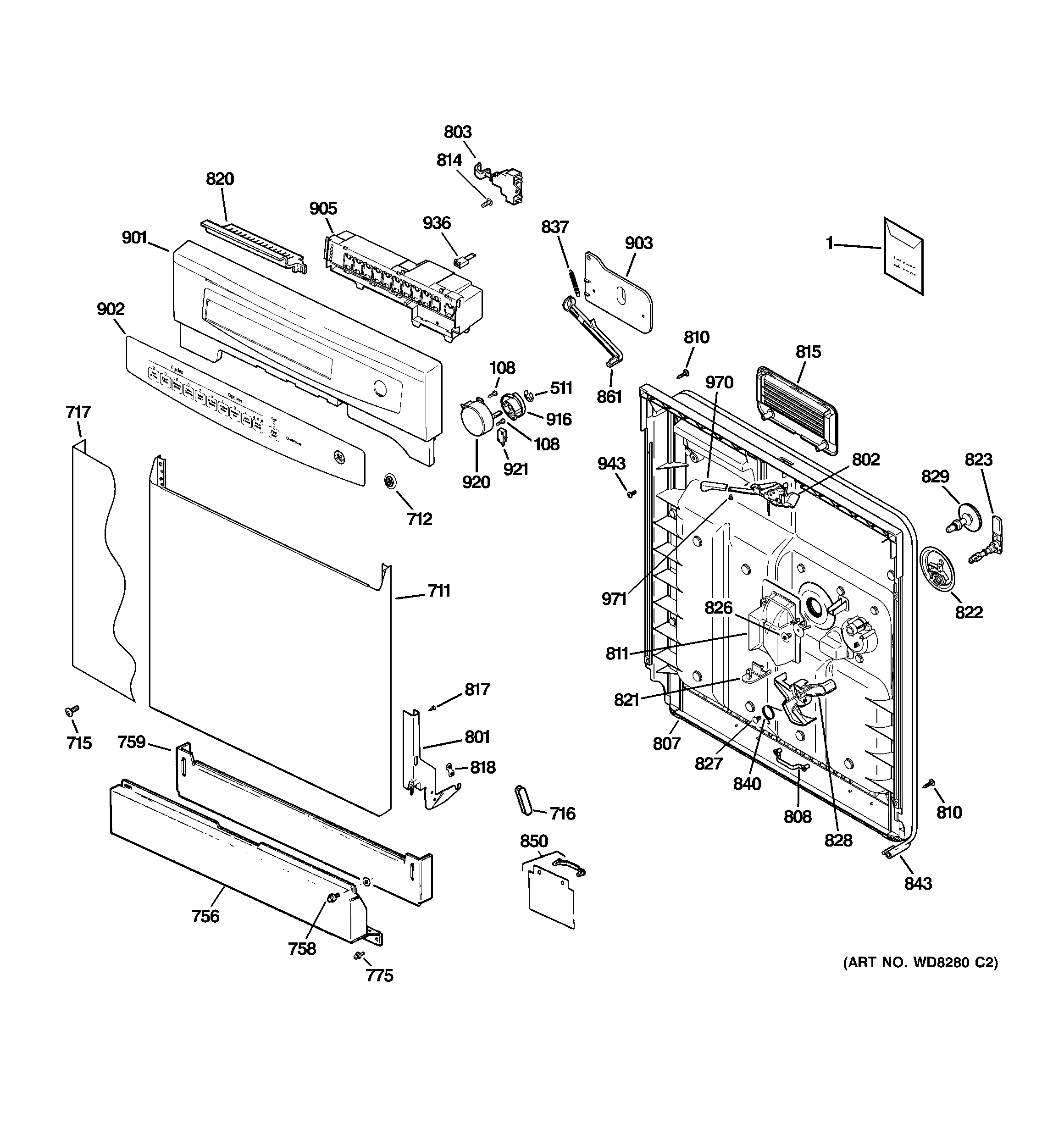

mysterious dishwasher---- drains just fine, plunger goes into solenoid and good strong drain but the wierd part is the water valve is energized during final drain phase(actually all the drain phases) and it fills with water while its draining with the end result being when cycle is finished there is still water in the tub. didnt believe my eyes so i unplugged the water valve when final drain started and when cycle advanced todry the tub was fully pumped out. thought possible some connection to float and float switch but checked float and it was free and checked switch and it opened and closed properly. any ideas would be appreciated----baffled

I can't find the service info for that model,
but it would seem to be a bad Controller
http://www.repaircli...tDetail/1556540

that would make sense but this unit is real plain jane with a regular dial type mechanical timer just like the old ge potscrubers etc. . however homeowner said it is nearly new which in homeowner speak means anywhere from 5 years old to ,well,nearly new like six months old. hope that info helps i could sure use some advice on this one. thanks for your response.
which part ?
GSD4000R15BB Parts Diagram

well this is wierd i would say part no#916 but that obviously isnt a regular mechanical timer but it sure feels and looks like one when you turn it. looks just like the plain old nautilus i bought my mama abought 8 years ago or the ge potscrubber that every builder in texas installed for the last 25 years or so in new homes. is that 905 or 820 a controller or just a run of the mill selector switch ? thanks for the diagram.
