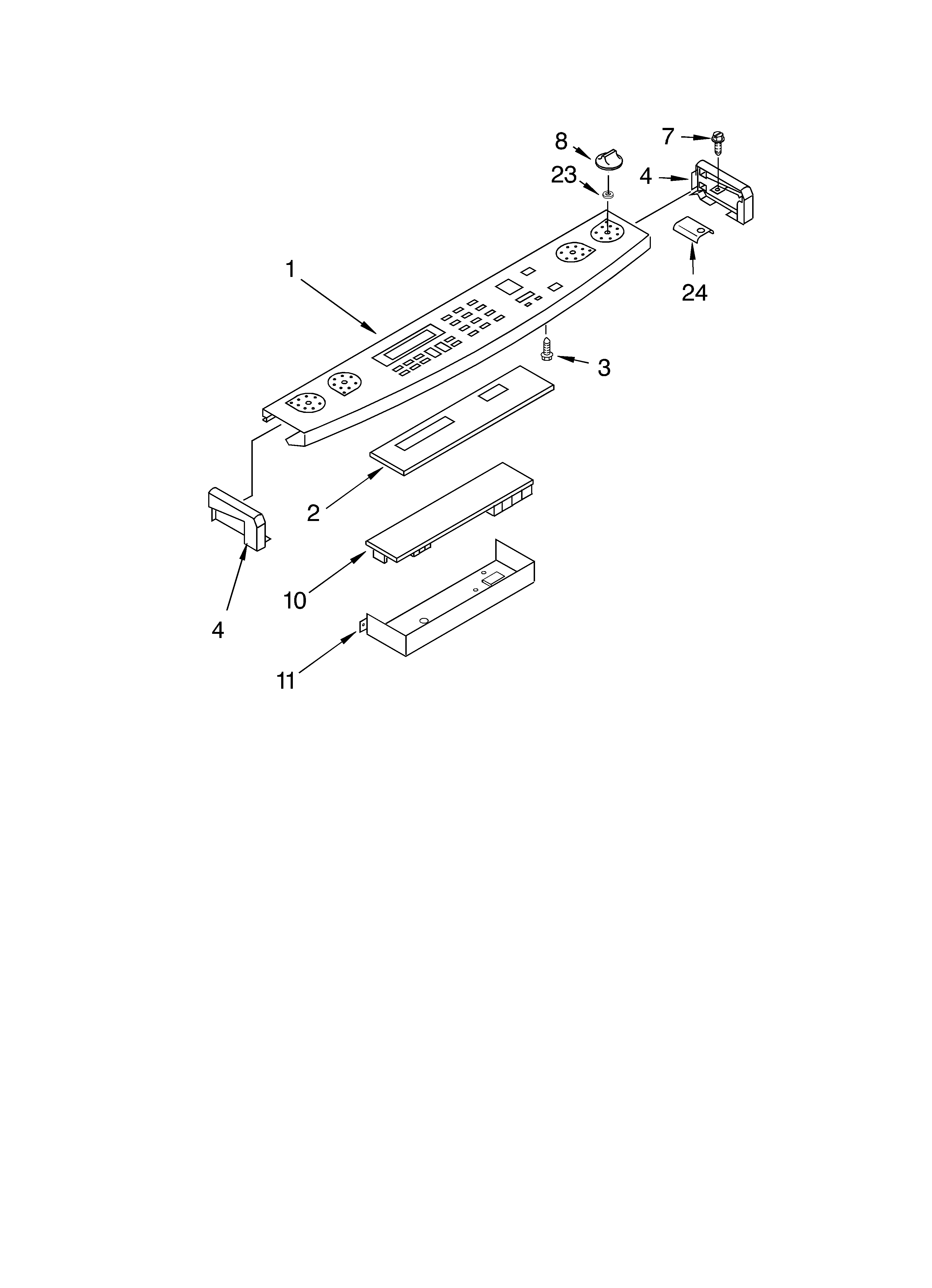

... but didn't know if I needed to pull the back of the oven or not ...
... how do you get to the thermal fuse in the cooktop?
1) yes
2) To remove the control panel:
a ) Remove the screw from each end cap.
b ) Open the oven door and remove the three screws from the bottom of the control panel
c ) Pull the knobs off the gas valves.
d) Lift the front of the control panel, pull it forward,
and slide the front edge of the cooktop glass out of the slot in the front of the panel.
e) Rotate the control panel up and over so the bottom side faces up.
... Have you used self-clean lately ? :nono:
