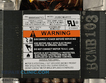

... I think we'll pull the motor out for a motorized scooter .
195v 3 phase scooter ?
#6 Scottthewolf
Scottthewolf
    Senpai
  • 1,911 posts
Posted 16 August 2012 - 04:45 PM
You'll need the control board to go with it.
Scott Wolf
#7 RegUS_PatOff
  • 30,192 posts
Posted 16 August 2012 - 07:24 PM
and a looooong extension cord
