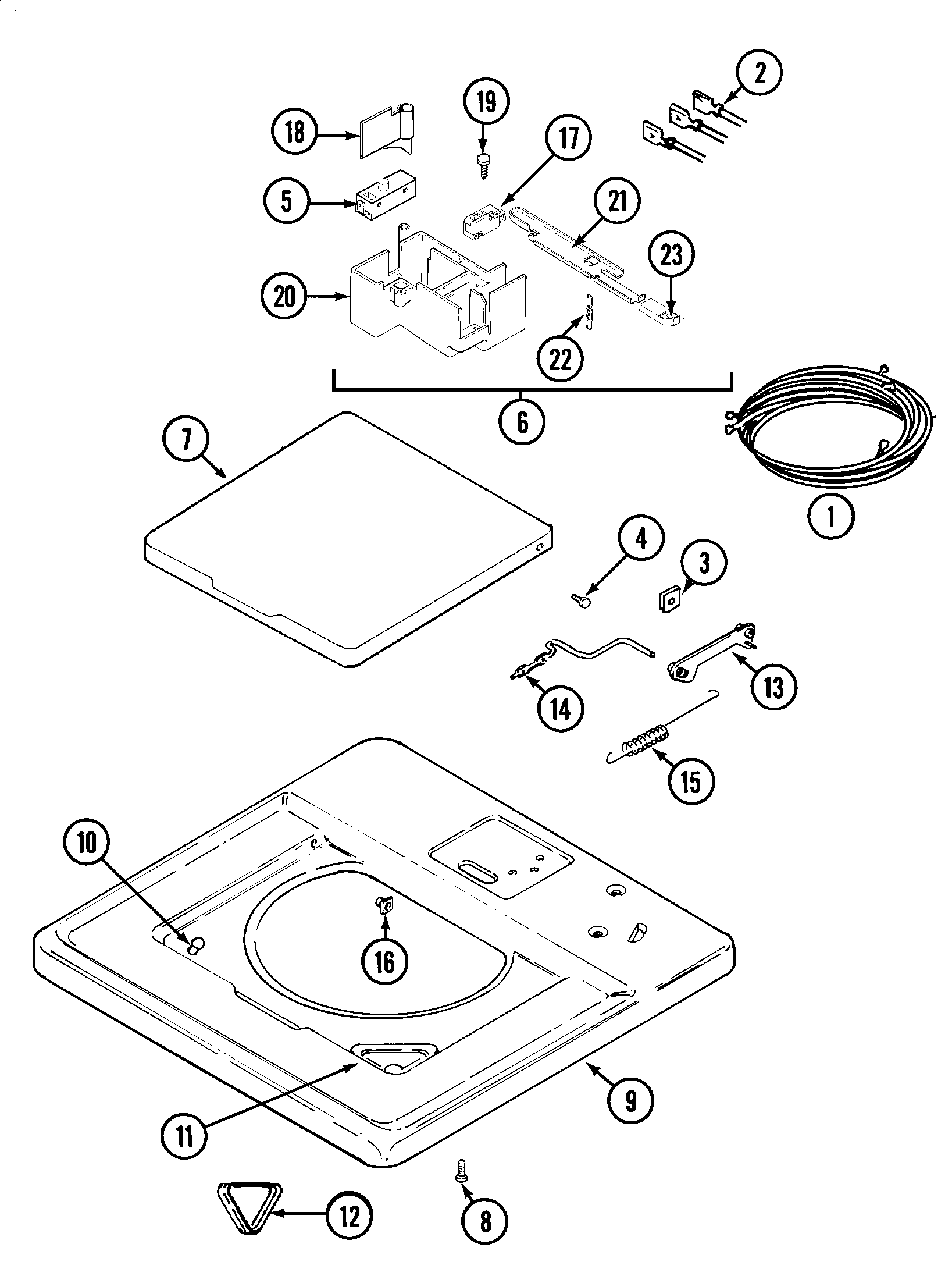

seems like one of the Lid Switches (or actuators) is bad
It would be the either the "big" switch or the "smaller" switch
It would be the one with the Red wire and the Black wire
"big" switch # 5
http://www.repaircli...rtDetail/436284
"smaller' switch # 17
http://www.repaircli...rtDetail/436285
OR new Switch Assembly # 6
http://www.repaircli...rtDetail/454350

Okay, let me take a look. Interesting that you said its the lid switch because when I disconnect the power from both machines and then reconnect it, the "IE" ERROR shows on the display, if i open the lid and close, the ERROR clears and the machine begins to fill up. I know its hard to tell, but could any of this been caused because it was overfilled with laundry? Thanks!

Bingo!!!!!!!!!!!!!!!!!!!!!! :rocker:
I removed the top, located the switch, tested the connection by doing a hard connect (red/black) and the machine began to spin.
It looks a little worn and toasted inside....
Lid Switch (Small) Part #436285

Thank you so very much for your expertise and patience. I went to a local parts store and replaced the switch with a generic micro switch for $6.71. Laundry getting done tonight...I am out of the dog house....for now. :thanks:
