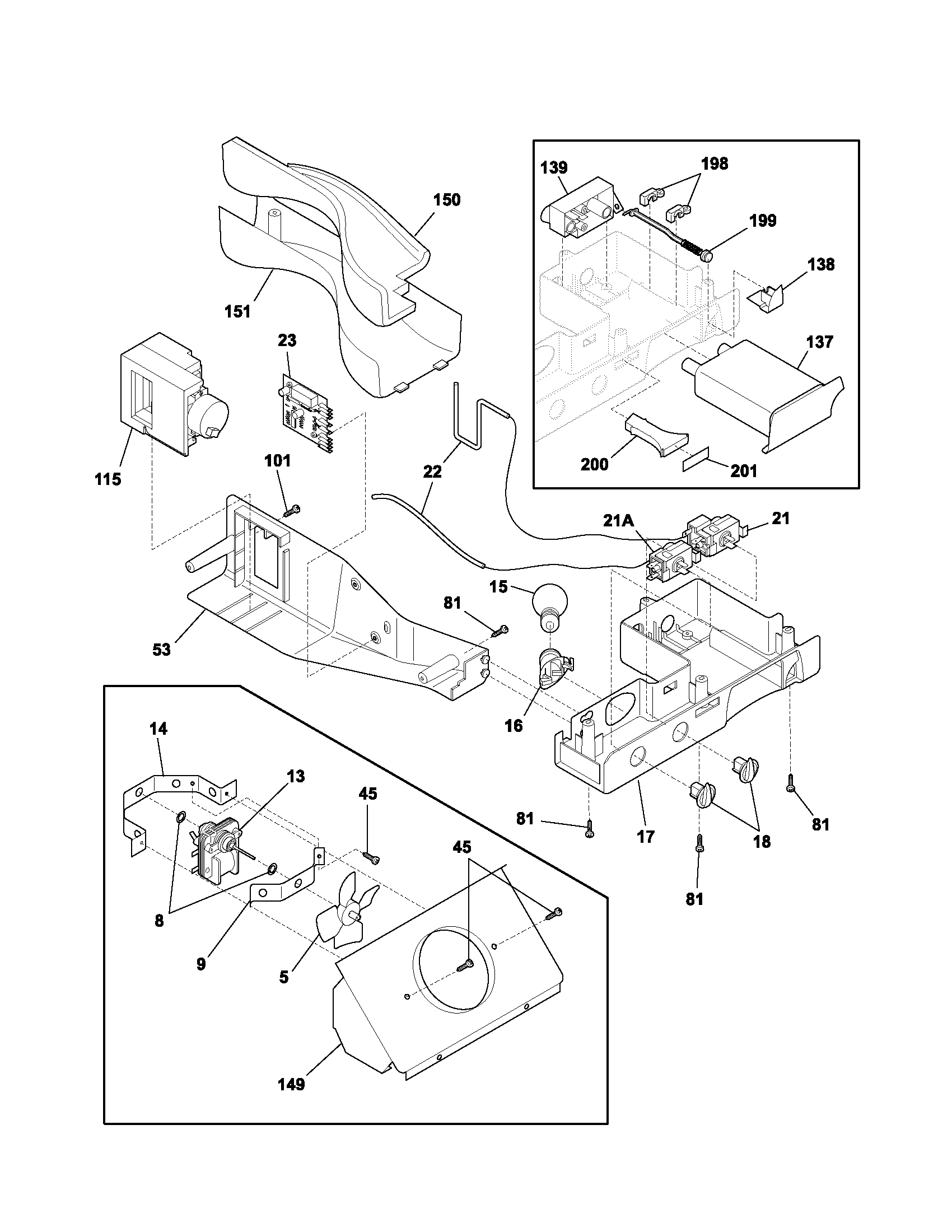

Thanks to the flowchart I'm trying to test the defrost heater first and haven't been able to unplug the part. I don't want to cause more problems than I've got already. I can't see the plug well enough to see if I can pry at the connection. Is there an area I should be pushing in like a release tab or something? Will it hurt anything to grab ahold of each side with pliers and pull?
Is the power supply side a female connector that I should worry about crushing if I use pliers? I'll be greatful for any help/suggestions to help me move forward with this.
Thanks.

Click on the link and it will show you where to pull the connectors apart.
http://www.repaircli...03918255/833635
These defrost heaters rarely fail. Usually the problem is the defrost thermostat.

no need to disconnect anything (besides power) in order to do an OHM test on the Defrost Heater

Scott, I see where the plugs(heater) are and have tried to pull them apart with no luck. Can I grab the two sides w/pliers and pull w/o messing anything up? and should I test the thermostat first? if it's bad, should I still test the heater? Thanks.
and RegUS_PatOff How can I check w/o disconnecting. There isn't a plug to probe like in your video. Thanks

... How can I check w/o disconnecting.
probe into any of it's Connectors or at Defrost Board w/ or without removing the Connector
Have you tried doing a forced Defrost mode ?

I finally found the place to probe to test the therm. & defrost heater. If I had bent over further earlier, I would have seen the multi wire plug kinda pushed up high above the therm. When I tried to force the defrost with the light switch, I got nothing.

If the Defrost Heater and the Defrost Thermostat Switch test OK,
then sounds like a bad Defrost Controller

The ADC arrived today. Yaay! That was the good news. The bad news is that I can't get the front piece where the freezer section/frig. section control knobs are located to come down. The service manual mentions a screw where the filter is but there isn't one. Other than that I've removed all the screws I can find and it's holding on tight. I've taken pics so I can look more closely but I'm not recognizing any clips but I'm guessing I just don't know what I'm looking at/for.
Will someone please direct me in this.
