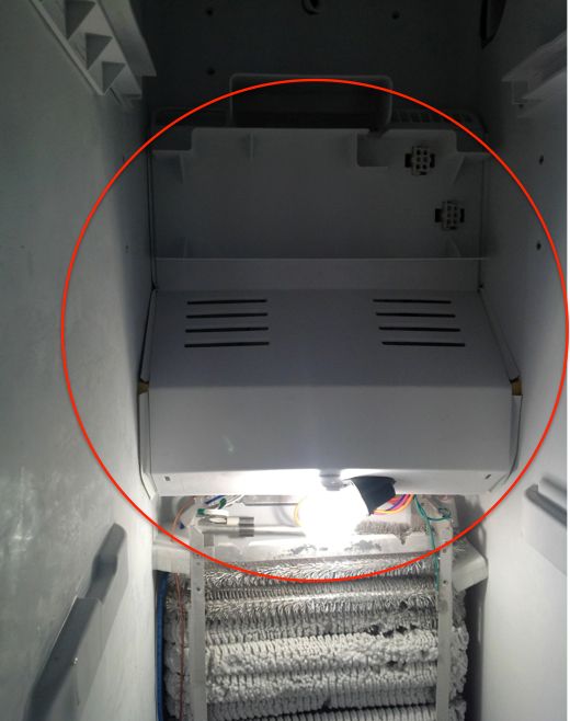

Ok - I got the back wall off and everything is covered in ice.
How do I turn off the freezer section but leave the regular side on?
Here's a pic of what it looks like. I've got a hair dryer in it now trying to get the ice off.
Edited by Shawnna, 09 September 2012 - 05:32 PM.

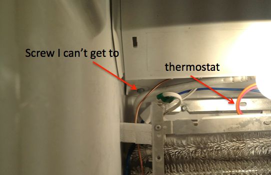

Ok - please tell me what happens if I replace the defrost heater without replacing the defrost thermostat?
I can't get to the thermostat to replace it with the tools I have.
So what happens if I just replace the heater?

It's most likely the thermostat is ok. Replacing it without testing it is a precaution. You can't get to the thermostat to cut and splice the wires?

I don't think the defrost thermostat is likely to be bad; it doesn't cycle off and on with every defrost cycle like most of them do; it is just there as a safety device. If you're not able to use an ohmmeter to check the heater, a visual inspection can tell you that it's bad

Nope - can't get to one screw to get the cover off to get to the wires. :down:
Well.... I got the old heater out easily - and it looks bad to me when comparing it to the new one.
What I'm concerned about is the service manual says this:
I've got it going now and it's cooling down nicely with the new heater in it. I'm tempted to just put it back together and see what happens. But before I do that, I wanted to check in with all of you and see if I should worry about what the manual says? If so, I'll leave it apart and call a repair man.
How much of the freezer have you disassembled? With the back panel out, the thermostat should be right there on top. Is it caked in frost? Post a photo so we can see what the problem is.

I've got everything but this one cover off. Here's a pic with the cover I need out circled.

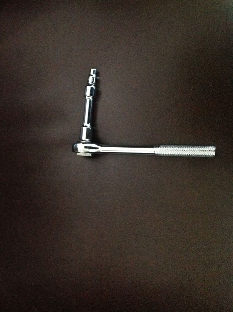

Here's the tool I'm using to remove the screws - it's the only tool I have that fits the screw head.
And here's a close up of the screw that I can't get to.
