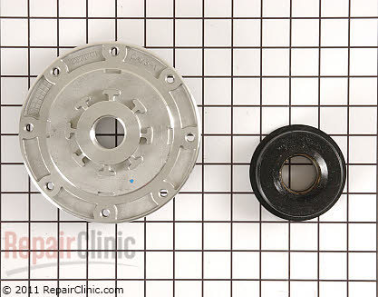

Helix ==> http://www.repaircli...mber=SAV5701AWW
Drive Pulley ==> http://www.repaircli...mber=SAV5701AWW

No RegUS that is not the one, (that's the lower bearing that goes in the milkstool), this is the plastic tub SpeedQueen style. He needs the upper spin bearing that is encased in a rubber housing to press into the plastic tub, it comes in the "Triple Lip Tub Seal & Bearing Kit".
Tub Seal and Bearing Kit W10116791
http://www.repaircli...0116791/1258432
Tub-Seal-and-Bearing-Kit-W10116791--0090
