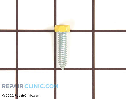

Back a few posts you said the basket was rotating with each agitation stroke. Just humor an old searsie and look at the center of the base and teel me that the shipping bolt isnt still in the hole. standing by....

. Just humor an old searsie and look at the center of the base and teel me that the shipping bolt isnt still in the hole. standing by ..
Shipping Bolt # 37
#14 kdog
    RoughShod
  • 7,428 posts
  • Location: Canada
Posted 05 October 2012 - 11:24 PM
Usually bright Yellow in color
#15 RegUS_PatOff
  • 30,275 posts
Posted 06 October 2012 - 12:02 AM
aahh, yes

Tenant reports no shipping bolt. Also, what I thought they reported as the agitator cams slipping (ratchety sound when I heard it) is instead some kind of "clunk" that only happens with the new agitator.
