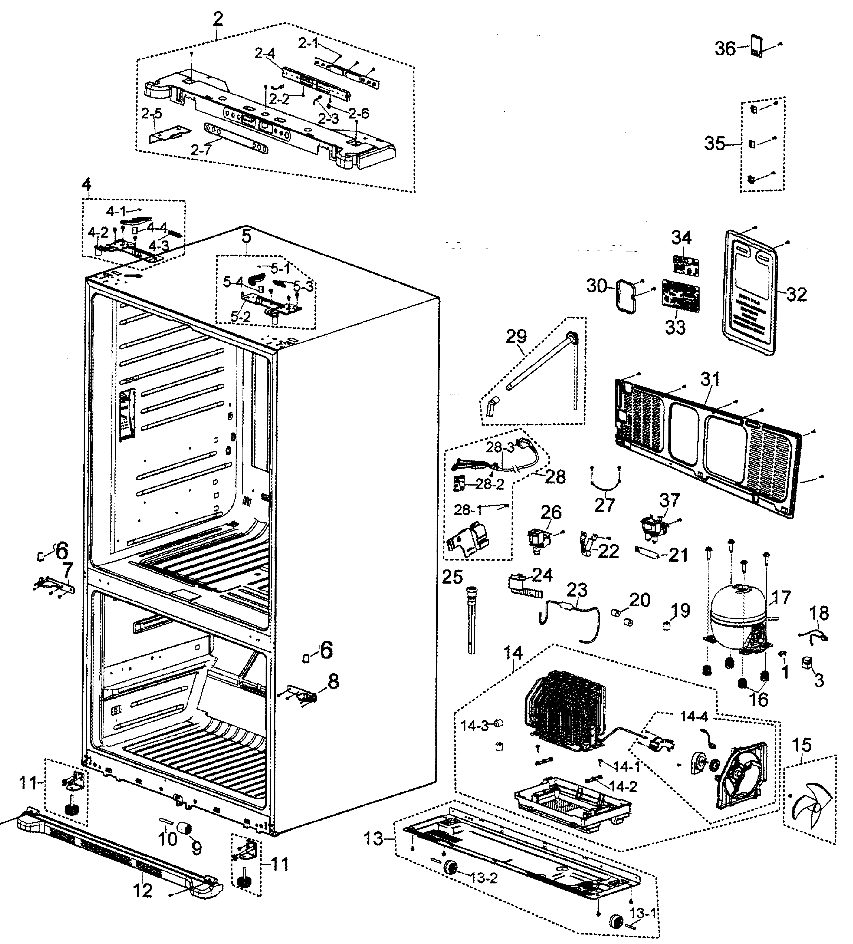

I can't find a picture of the buttons on your control panel (upload one) ?
Sears shows that your control is # 2
DA97-07049Q
the same part number as on
RF26XAERS
RF26XAEWP
which should be included in the service manual
