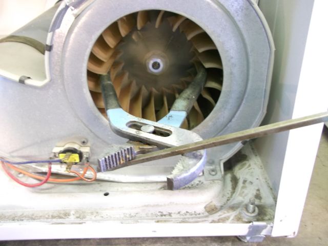

Leave the dryer on top of the washer, it is a bit easier to work on than on your knees, bent over.........If you got down to the motor last time, when it comes to replace the motor, try this to help remove the blower from the motor shaft.....Posted Image.......Use a medium size pipe wrench on the pulley end and use a pair of slip-joint pliers inserted into the blades and a screwdriver as a handle for turning/rotating...................The pliers I have are Craftsman w/rubber coated handles.......There is an ARROW on the blower itself, so you will be turning the blower clockwise...... Have not broke off a blade yet................ This is the system I use on W/P's also...
