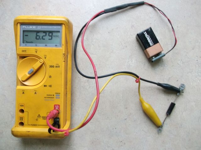

Diode/rectifier tester
No replies to this topic
#1 certified tech group 51
  • 1,977 posts
Posted 29 September 2012 - 10:46 AM
From the old days , when you had a few to test with out fumbling.....Made with left over meter leads............
......and some Radio Shack stuff...
