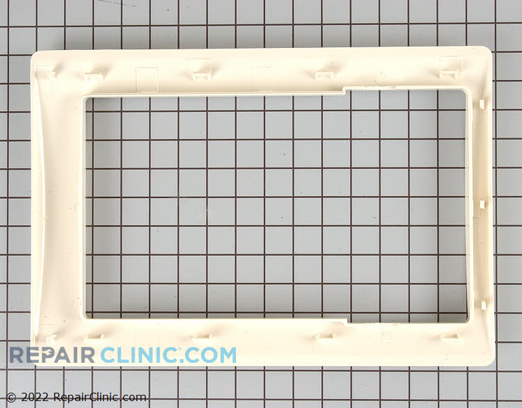

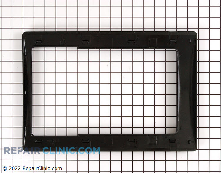

Damned if I can see the slots to get the trim off. Are there two on the outside, bottom edge? I'm going to have to get a magnifying glass to see them I guess.

Here is what the back of the trimpiece looks like:

may be a little easier to see on this beige model
