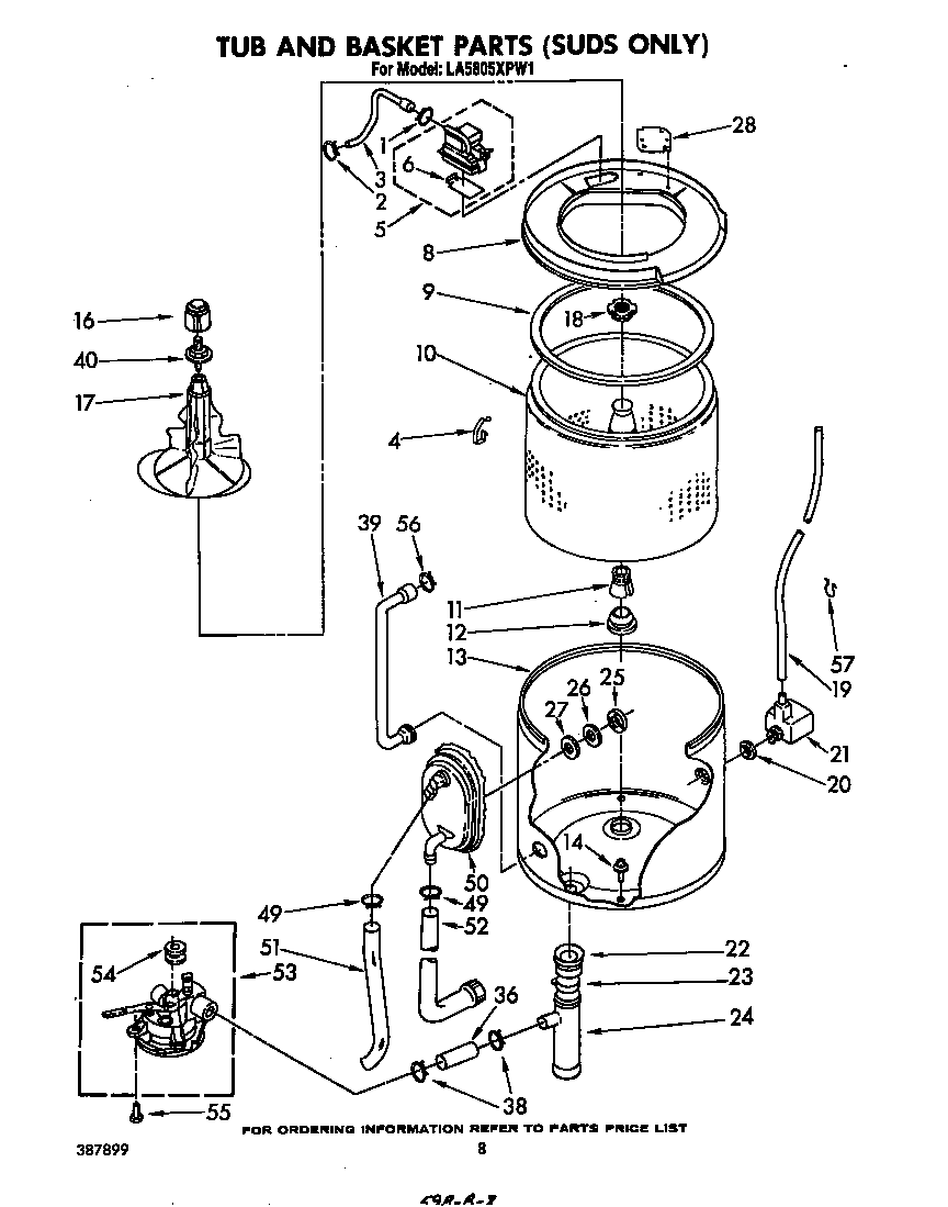

Yes, that is it exactly. It looks like my point of access is through the basket instead of the bottom? Is it possible to include the page that names the parts? As I looked at it from the bottom, the juncture ( at the base of the basket) is rusted, not rusted through, but rusted. The original clamp may not be holding well because of that ---there just may not be as much to hold onto as there used to be.

I want to add that when it loosened, when I took the drain pump off, it looked as if there was a rubbery compound right at that juncture. I wasn't sure what that was and made no attempt to remove it or modify it. It looked sticky enough that it was helping that juncture stay in place.

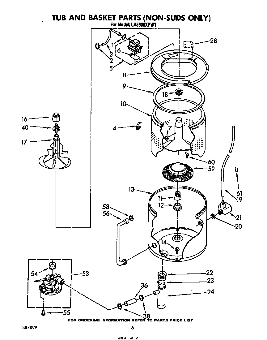

Yes, that is it exactly. It looks like my point of access is through the basket instead of the bottom? .
that's the diagram for your model number ...
here's a similar model

1 353366 Clamp, Hose
2 353367 Clamp, Hose
3 356349 Hose, Water Inlet
4 359763 Clip, Tub Ring (4)
5 366072 Inlet, Water
6 355584 Flapper
8 381971 Ring, Tub (Includes Illus. 28)
9 383553 Seal, Tub Ring
10 384024 Basket
11 357782 Block, Drive
12 96690 Gasket, Centerpost
13 359668 Tub
14 370571 Screw & Washer, Tub (4)
16 358431 Agitator Cap Assembly
17 383951 Agitator & Insert
18 21366 Locknut
19 353402 Hose, Pressure Switch
20 351830 Seal, Air Dome
21 360804 Air Dome Assembly
22 93553 Hose, Tub Outlet
23 9421321 Clamp, Hose
24 84091 Manifold Assembly
25 92229 Nut, Spanner
26 92232 Washer, Fibre
27 92235 Washer, Rubber
28 355852 Plate, Snubber
36 92231 Hose, Pump To Manifold
38 272858 Clamp, Hose
39 352978 Hose, Bleach Dispenser
40 358440 Stud & Seal, Agitator
49 353096 Clamp, Hose
50 368772 Filter
51 359798 Hose, Filter Drain
52 357052 Hose, Filter Drain
53 358036 Pump (Complete) (Refer To Page 5 For Further Breakdown)
54 359630 Pulley, Pump
55 386011 Screw and Washer 5/16-18 x 7/8 Pump To Gearcase (2)
56 287859 Clamp, Hose
57 387551 Clip, Pressure Switch Hose

Un-freezing the drain pump was a temporary measure. I ordered a new drain pump. The only connection we are having trouble with is at the bottom of the basket. How is the manifold assembly secured to the bottom of the basket? In the diagram above, this is #22, #23, #24. It has loosened from the bottom of the machine and we can't figure out how to make that connection tighter. Installing the new drain pump is no problem at all, except this connection. Thanks for any and all help you can give me.

are you talking about the tub grommit ? , the rubber part that hangs from the bottom of the tub ?  #22 above , there calling it a hose but it's not it's just a rubber fitting on the bottom  of the outer tub
if that's it , just replace it , this is something i even stock , it's not a big deal , i think i pay around 5 bucks for them
you take the sump and clamp off and fold it in on itself and take it out (sometimes there so rotten you can just rip them out)

#22 Hose Grommet
http://www.repaircli...sp?R=154&N=3363
