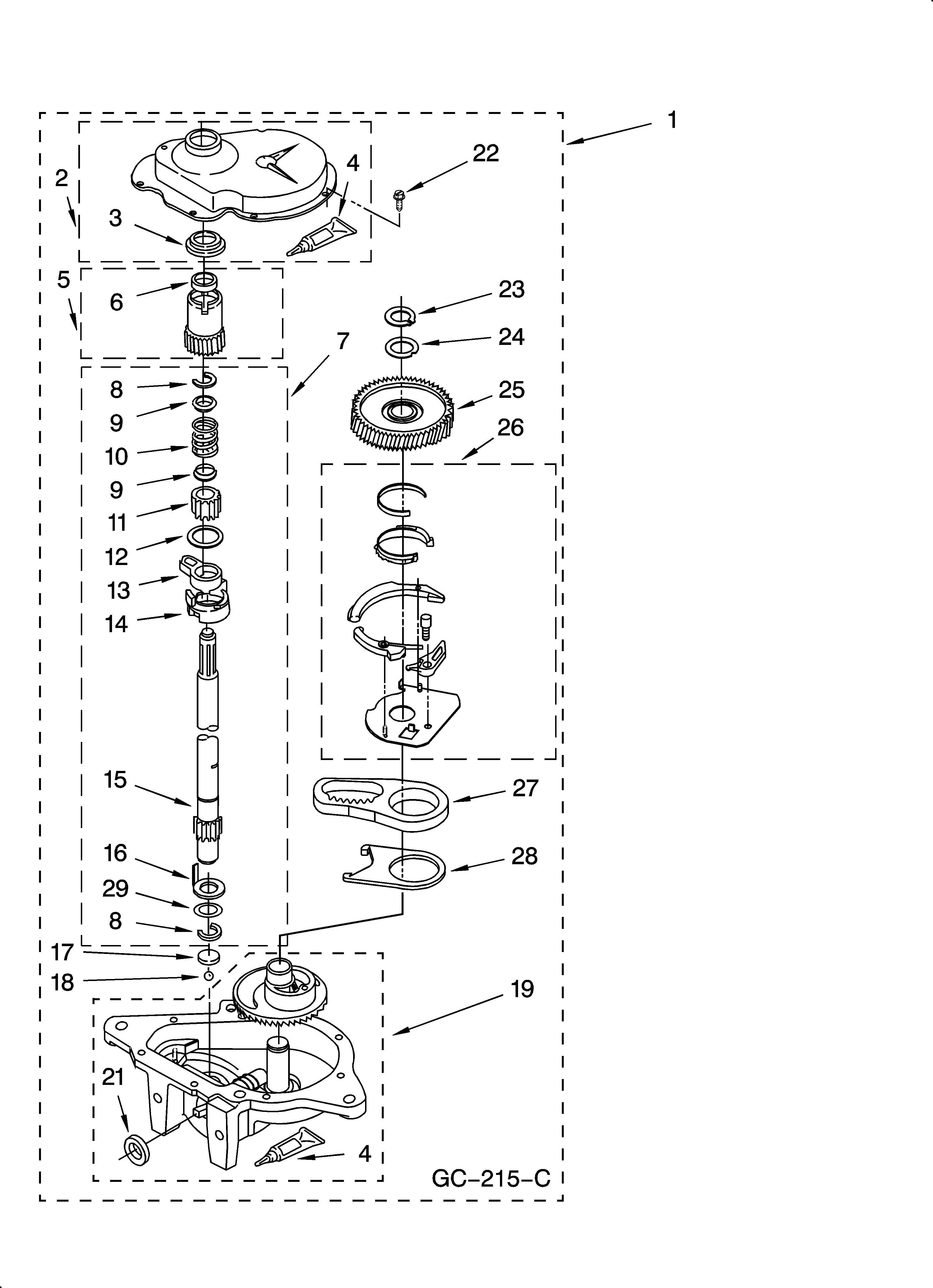

#33 RegUS_PatOff
  • 30,708 posts
Posted 19 October 2012 - 01:50 PM
Spin Pawl
http://www.repaircli...rtDetail/670561
part of assembly # 26

#35 RegUS_PatOff
  • 30,708 posts
Posted 19 October 2012 - 10:03 PM
Is there a way to be sure that this machine wasn't one of the early ones?
Whirlpool WTW5505SQ1 c.2007
and parts diagram of your Washer (above)

I see that there is a neutral drain kit available. Is it likely that this is just a problem with the spin pawl?
#40 Budget Appliance Repair
  • 4,032 posts
Posted 24 October 2012 - 07:52 AM
The neutral drain kit will generally always fix the problem.
It has been mentioned by someone a while back ago in this forum when this same discussion came up that the spin pawl is the part that wears out causing the neutral drain to go directly into spin instead of neutral draining properly.
Quite some time ago I ordered just a spin pawl to test this theory but have never taken the time to open a transmission up to install it and test the theory. I have no doubt that just replacing the spin pawl will correct the problem, (it's pretty much the only part of the neutral drain kit that seems to be a wear point).
