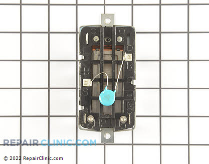

A hot wire relay is used to cycle the high amperage circuits, (heating elements), using a low/110 volt signal from the t-stat. When the 110 volts is supplied to the hot wire relay a bi-metal will heat up causing the contacts for the element/s that it controls to close, energizing the elements. Keeps the high amperage load off the t-stat cycling contacts.
Here's what a "Hot Wire Relay" is and looks like:
http://www.repaircli.../414589/1015826

They were used mostly in the old GE's and Frigidaires. This one that I found to show you what they are is a Bosch part - I've never worked on a Bosch range/oven so don't if it is something that is commonly found on Bosch ranges/ovens or not.
An older Whirlpool built-in oven that I worked on recently had what looks exactly like a RobertShaw infinite switch but without any shaft - basicly the same function of this hot wire relay that you are asking about, the RobertShaw infinite switch style hot wire relay is also used in Thermador ovens.

Yeppers, I have revived many a Thermador pro range with a hot wire relay, but it usually looks like the one in the photo.
easy to diagnose, though. If you are getting yer coil voltage from the Tstat, but she wont close...slam dunk.
