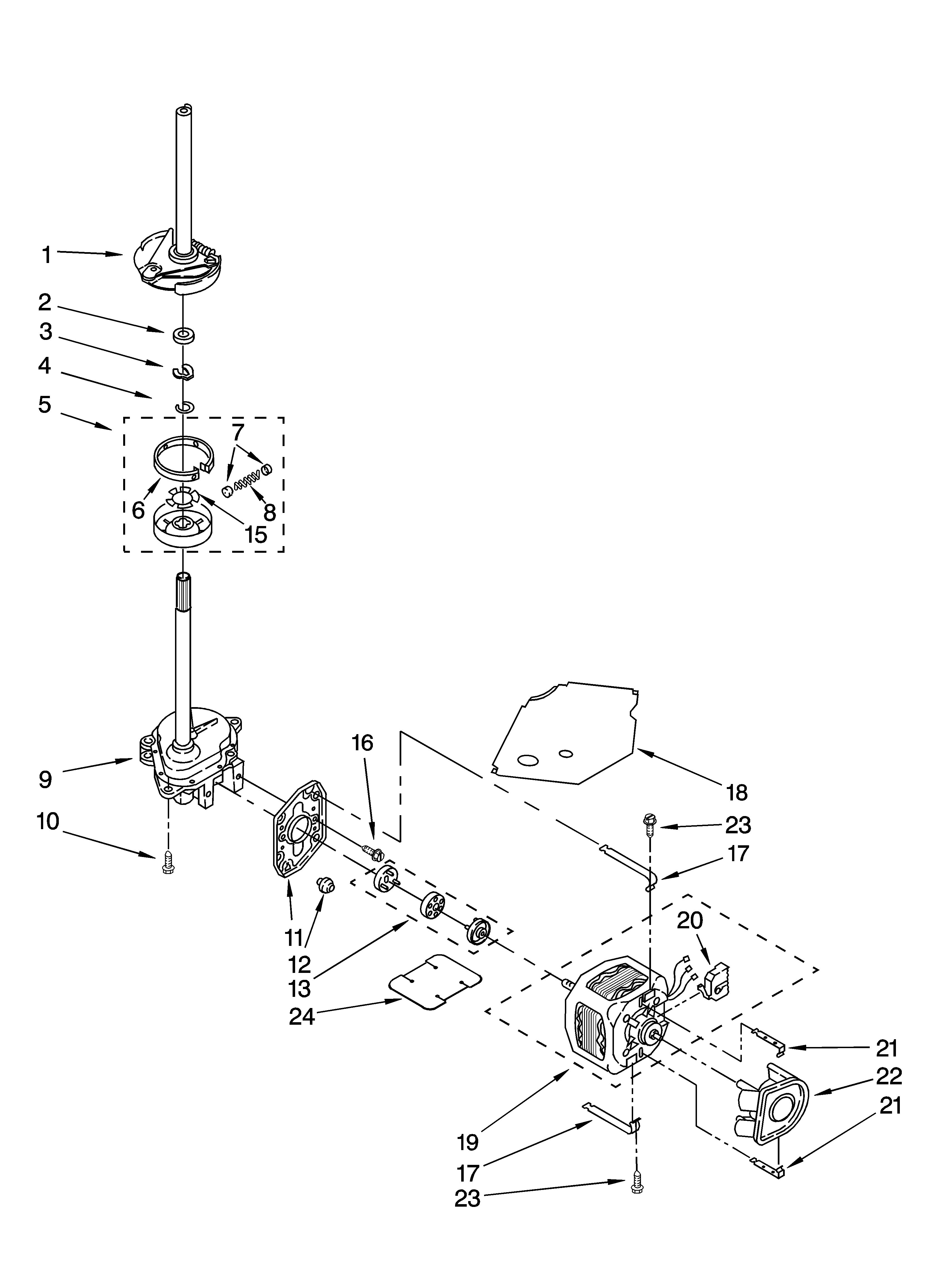

Hi, gang. I have lost my groove...
The washer agitates fine. Pumps water out fine. Won't spin. Sounds like it's spinning but is isn't. Sounds like a jet taking off.
I checked the motor coupler. It's fine.
The notches on the drive block look good. (I think.)
The clutch pads still look thick, but they had a gray sheen. (Metal shavings?) I sanded them lightly. BUT, I found a loose C-shaped fastener in the bottom of the clutch and realized that the plastic cam (is that the word?) that normally moves the clutch pads had fallen off the bottom of the shaft that comes down through the brakes. When I tried to reinstall the cam up above, I saw that there is no longer a groove for the C-shaped fastener at the bottom of the shaft. The bottom tip of the shaft has worn away. (I tried raising the brake pads. There's just no groove, period.)
I haven't reassembled yet. Does that plastic cam have to physically be clipped to the shaft for it to work? Is that my problem?

It looks like the spin pawl (the "thumb" that's supposed to stick out on the white plastic piece in your photo) is broken off on the basket drive. I'm not finding it as a separate part number; it looks like you need to buy the entire basket drive to get the factory-installed spin pawl. You can see it in the photo on this page ==> http://www.repaircli...ive/285792/1254

I know my pics were really small. Here's a closer look at the spin pawl. Let's see... I know that with the transmission out, the spin pawl slides up that tiny bit of shaft that pokes out through the middle of the brakes on the basket drive assembly and the spin pawl previously was held in place by a little C-shaped clip that goes in a groove along the bottom edge of the shaft. But there's no longer a groove at the bottom edge of the shaft and the metal looks worn. I guess my question is: Does the spin pawl have to be clipped to that shaft to function?

Yes, there is a clip that holds the spin pawl on to the basket drive shaft:
If you're saying the shaft itself will not longer hold the retaining ring, then, yes, the basket drive would need to be replaced. You could buy a new washer if you want but you probably won't be happy with the new stuff out there and whatever you buy will be more expensive than replacing the basket drive in your good ol' direct drive washer. This is one of the best T/L washers ever made and they're not making it anymore. Personally, I would hang on to it as long as I could. But I'm just stubborn that way. :samurai:
