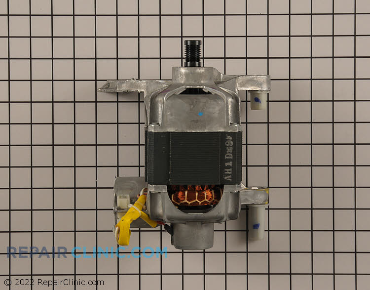

This unit wont go into Hi speed spin. I ohmed motor it ohmed good. The tech sheet says its either a motor or MCU. During spin it will drain fine, it will tumble back and forth but never go into a hi speed spin. All it does in spin is alternately drain for awhile and tumble over and over till time expires. There is no error codes stored or displayed. I think its the MCU what do you guys think?

Same thing. It drains, spins a little while slowly, starts to speed up a little, stops, drains , then does it all over again and again. Almost like it wants to spin. With no error code. The diagnostic runs through all the tests fine, but no hi speed spin it just does the same thing I indicated above.

Hmmm - did you check the wires between the motor and MCU for continuity? If all is well in the wiring and the motor Ohm's out correct (you checked the tach as well, right?), then it's a crap shoot. The CCU is what tells the MCU what to do ... but the MCU sends the feed to the motor - either one could be the issue. I would start with MCU as that is where the most problems have been with this unit.

The tach is part of the motor. It is the two end wires and should measure something like 120 ohms (double check that as I'm going by memory.) If you can see the wires where they go into the internal part of the motor, the tach ones are usually red.

I unplugged motor and ohmed it out though. It ohmed 6.3 ohms. Your saying the motors tach could be bad but motor fine?

Tach is in the end bell of motor - seen here with the red wires as described:

I saw those wires. But if tach is bad then I need a new motor? And is 120 ohms correct? What is proper ohms? Thanks.

Yes. When you check the motor, you are checking between pins 1-2, 1-3 and 2-3 all for approx 6 ohms. Those are the motor windings. Pins 4-5 (or is it 5-6 with a blank in position 4, can't remember), anywho, the last two pins are the tach. If the tach is out of spec, the motor will not spin at correct speeds. It can do other wierd things too by confusing the CCU.
Yes, the tach is internal on the motor which means the whole motor needs to be replaced if tach is bad.

Thank you. Do you know the correct ohms?

Somewhere in another post 116 ohms is mentioned - so his foggy memory of 120 sounds accurate - must be the low altitude

If Kdog posted the correct picture, then that one is approx 120 ohms for sure.

Hey Deezus, The tach is short for tachometer. It measures the motor revolution speed to send back to the ccu as a feedback to calculate the motor speed. If it is bad or has a loose connection it could cause your problem. Hope this helps.
