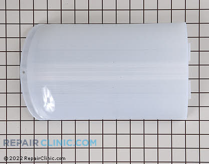

This is my day to feel beyond stupid. One of the light bulbs at the top of the fridge under the center cover has burned out. I CANNOT get the cover off. There are 4 tabs - no problem. There is what looks like a plastic screw upfront. The manual says "on some models you have to take the screw out". Ok, so I tried to grab the serrated flat knob and twist. Nothing. Then I tried my trusty Leatherman. No budge. Then I worked my way up to a friggin Channellock. Still wont turn. If I squeeze any harder and try to turn it I will break something. There is a hole in the center of that "screw" and something there, tried inserting a small regular screwdriver in there and it wont grab anything.

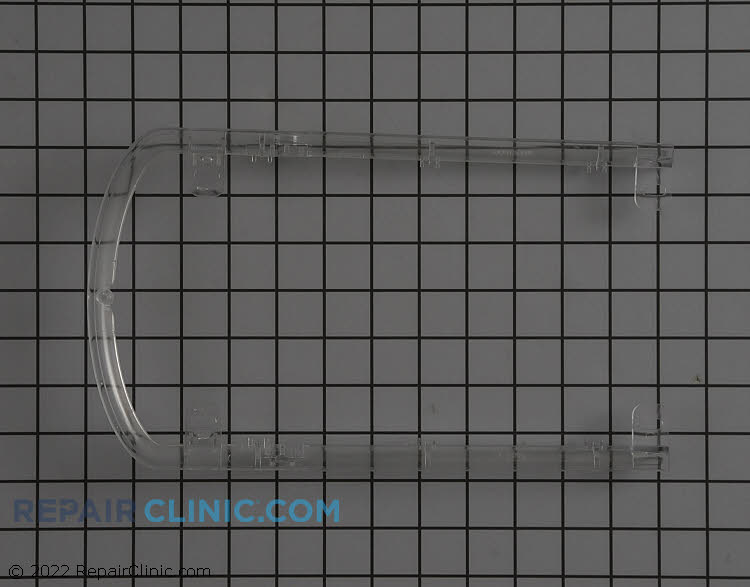

Looks like there's a screwhole
http://www.repaircli...6284&locID=2213

http://www.repaircli...?R=154&N=914220
