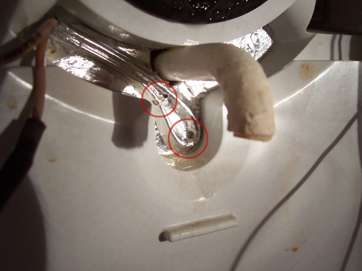

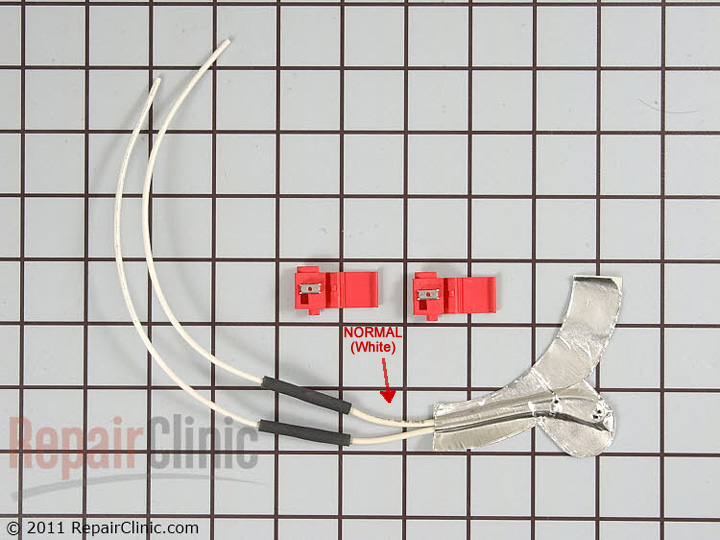

So, last night I was inspecting the heating element, and I noticed that the foil covering the actual loop at the end seemed melted or something.  That, along with the discoloration of the wiring is making me think the element burnt out.  Here are some pics (the melted parts are circled in red; last picture is new part for comparison):
What do you think?  Is this heater bad?  Should I replace it?  (Just trying to avoid spending $$ on part that might not be the problem.
Arigato, Fermented Grand Master and RegUS_PatOff Sensei.

... What do you think?  Is this heater bad?
.. if the resistance is reading 100 OHMs
(without loose / intermittent connections)
then the Heater should be working
(you may be able to feel it's warmth)

No impressions on the discolored wires and the apparent "melting" of the foil covering?
When I first disassembled, I felt the heater, and it did not feel warm (but the heat is so slight, it may not feel warm).  Ruling out a foreign body blocking the dispenser tube (0.01% chance of that), I'm figuring the thing is frozen again - which leads to the conclusion the heater is bad, even if the resistance reading is correct....

I don't put a lot of stock in slightly discolored wire; burnt, yes, mild discoloration, no.  Doesn't necessarily mean anything and is not diagnostically useful.
Something can check good on ohms and still be bad.  Check the current draw with the heater installed.  Should get something in the neighborhood of 120 ma, assuming 12vdc supply and the heater rated at 1.4 watts.
