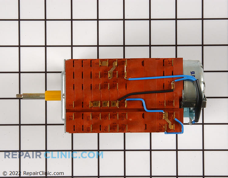

I went through the same troubleshooting steps as previously and now the voltages in step 3 to 5 are all 0 (measured them twice at different times). In step 6 the measure is 2.119 ohm. And previously the timer moved forward, it is not moving at all today. Makes me wonder, if I damaged something during the troubleshooting process?
So with the revised voltages I repeated the troubleshooting check list from “Tech Sheet” “(motor will not run)”
Step 3: “check the thermal cut out”. The resistance between 7 & 8 of the 10 pin plug for the motor connectors is 0 ohm. So that seems OK. See motor ohm measures below.
Step 4: “check timer contact 11 to 11A” – I do see 11A and 11B on the wiring diagram, which are the contacts nine plug pin 5 and 6 for the speed control board? Where are they on the washing machine?
Step 5: “check timer contact 24 to 24B” – I see 24 and 24 B on wiring diagram as a switch next to the pin 3 of the nine plug pin. Where are they on the washing machine?
Checking the motor resistances and the armature rotor winding has indefinite resistance, while the rest seems OK within the +-10%.

#9 RegUS_PatOff
  • 30,698 posts
Posted 25 November 2012 - 12:52 PM
1) ... Step 4: “check timer contact 11 to 11A” ... Where are they on the washing machine?
Step 5: “check timer contact 24 to 24B” ... Where are they on the washing machine?
2) ... Armature rotor winding: pin 5 & 6; recommended: <5 ohm; actual: indefinite; no connection!
1) on the Timer
2) doesn't look good

#11 PeterNil
PeterNil
    Ikkō-ikki
  • 39 posts
  • Flavorite Brew:Malbec
Posted 25 November 2012 - 10:33 PM
Thank you very much Reg.
Timer connections: 24 B is OK. 24 is not connected on the drawing nor on the timer. 11A and 11B connections looks OK, i.e. the cords going out from the plug are connected. Is there more to troubleshoot to explain why the timer stopped moving forward?
Armature rotor winding (pin 5 & 6) no connection! Any recommendation for a solution for this one?
In "addition" to the timer, motor and door lock replacement what else do you recommend? Apart from going shopping for a new washer :( .
Edited by PeterNil, 25 November 2012 - 10:41 PM.
#12 RegUS_PatOff
  • 30,698 posts
Posted 26 November 2012 - 09:23 AM
... 24 is not connected on the drawing nor on the timer.
... troubleshoot to explain why the timer stopped moving forward?
... Armature rotor winding (pin 5 & 6) no connection! Any recommendation for a solution for this one?
1) drawing shows a Brown Wire on Timer 24 connected to the Motor Controller C1.3
2) Timer Pull-Switch, Door Lock Switch, Timer 5 to 5A
3) that would indicate a bad Motor
