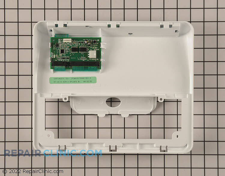

One of the conductors in the ribbon connector in the control box has an ultra fine break that separates as the box cools down (the metal contracts).
It's interesting to note that the entire control box assembly with the ribbon connectors, housing, and control board, is less expensive than replacing just the control board itself. Compare:
Control box assembly $165
Control board alone $240

The control box assembly is backordered til February 2013 at Whirlpool.
The control board is available.
But based on what you're saying, the control board by itself won't handle this problem??

The control board did not do the trick.
It turns out, the doors were not striking the light switches hard enough (go figure), and the computer
was sensing the doors were open. The customer glued something on the switch strikes and that
fixed it.
