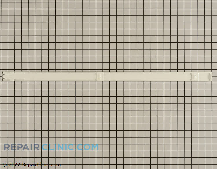

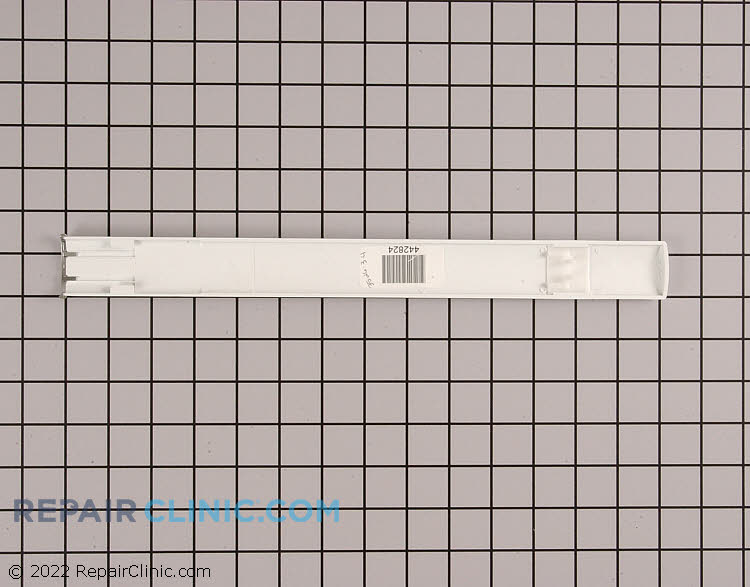

The handle on my Kenmore 25357672791 fridge just snapped off tonight. I found the handle
http://www.repaircli...er=253.57672791
and it's obvious it's held on by 2 screws on top, and 2 on the bottom, and those two trim strips cover the screws and wahtnot, and they appaer to be like "caps" if you will, and look like they might pry off from one side, and then snap back on, but I'm just guessing. Can someone kindly just tell me if I'm on the right track with these, so I don't break them too. Thanks in advance!

They slide on/off, top one up, bottom one down after un-clipping the two lower clips or double-sided tape stuck clips on the long lower trim piece:

and one clip or double sided tape stuck clip from the upper short trim piece:

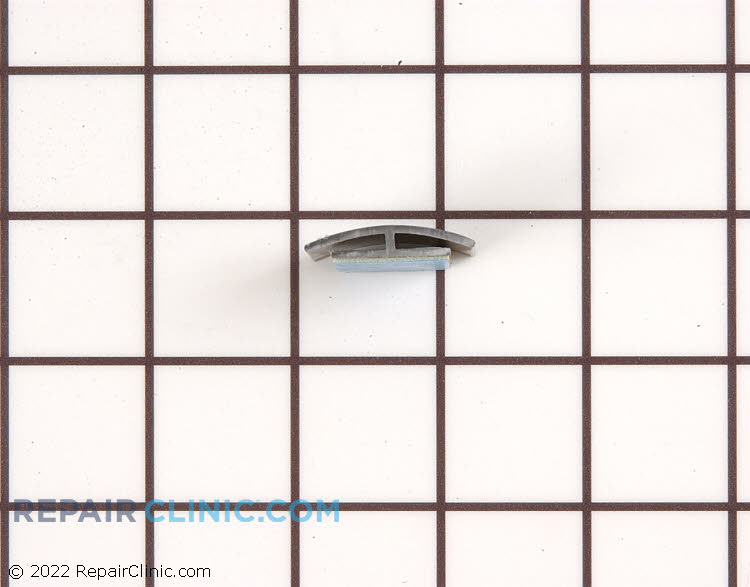

Yeah, the top clip broke, as it wouldn't slide up easily, and I pulled out on it. Of course, after you see how it works, I tool a small piece of wood and a rubber mallet and tapped the lower one straight down, and it came off perfect.

#7 Budget Appliance Repair
  • 4,001 posts
Posted 29 November 2012 - 07:50 AM
Or cut the protruding pins off flush and use a piece of double sided tape, pretty much just like a new clip would be mounted, if there is a flat enough area when the protruding pins are cutoff.
