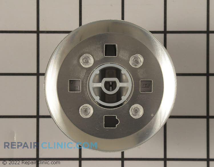

Is the timer closing BK-BU ??
Any chance the centre of the knob is stripped out giving the illusion you are on the cycle when you're not ??
