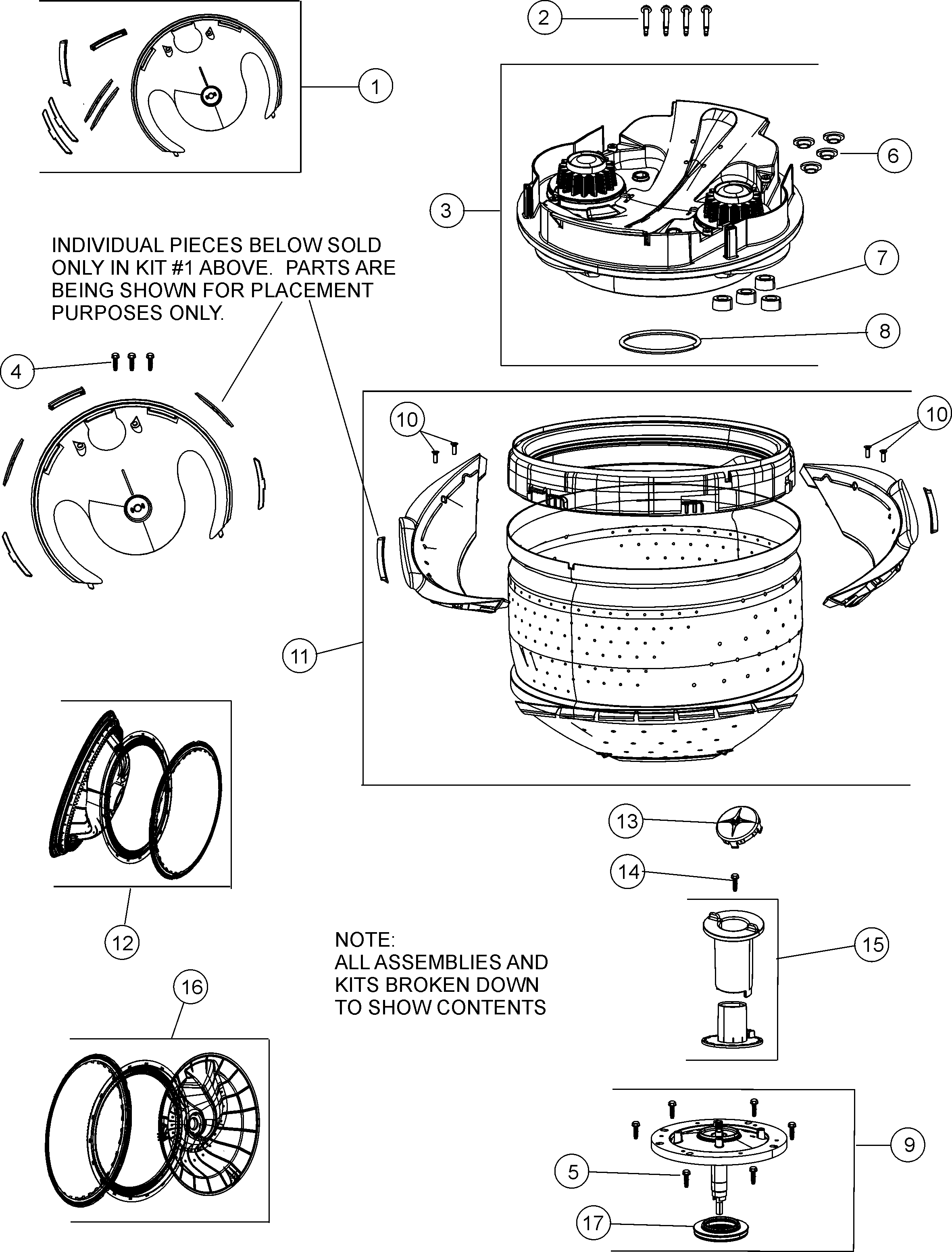

Maytage Neptune Top Load version, Model # FAV9800AWW.   The original complaint was a big leak over the weekend. Now  can't get it to leak at the fill valves, drain pump or otherwise, there is indications that the drain clogged and water ran down the wall and onto the floor then became unclogged at it drains fine now.   The other complaint is that it becomes out of balance very easily and shuts the machine down, particularly on the delicate cycle.  With all the fancy agitators and what not I didn't know if replacing the front shocks will fix it, or does all that stuff have to be in sinc to spin smoothly.  The front shocks seamed a little 'weak' and easy to push around, Thanks.

probably  has a bad clutch spinnin and agitatin at the same time

Bad clutch and spinning, sounds like an expensive repair, possibly toss it in the landfill?

for reference:
