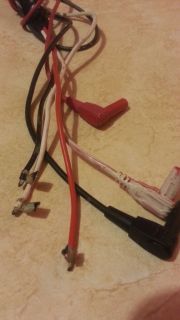

So you have some extra meter leads after buying the new fluke twistguard meter leads?
A few minutes making this useful meter lead thingamabob is time well spent. Cut the compressor pin connectors off of a dead 3 in 1 start relay and connect it to those extra leads with the probes cut off (don't discard the probes) . Make one more of these wires to complete a set of 3 . Now you have easily attached solid connections for ohm testing, much easier than alligator cilps. Connect them to the compressor pins in the same manner you would a 3 in 1 then simply connect whatever two of the three leads to the meter you want to test. And testing and re-testing can be done while standing up. I painted a red lead white to match the white wire cut from the 3 in 1. Simple yet useful, unless you are the Samurai and have all sorts of magical tools and weapons such as a compressor analyzer.
Btw connect two of the removed probes together and you have a nice jumper to use on whirlpool modular icemakers. Waste not want not.
